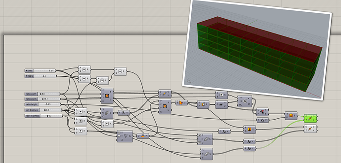

I am trying to make an array of warehouses. I have to have wall thicknesses accounted for so it is realistic in plan and section. I want all of the warehouses to have the same area but I want to be able to control this area via an x or y number slider. Attached is an image of what I am trying to achieve but obviously I want to extrude this too.
I am not too experienced in Grasshopper and I know it shouldn’t take as long as it has to solve this problem. Is anyone able to point me in the right direction?
Thanks in advance
Something like this: warehouse_ME.gh (13.5 KB)
Yes, this is perfect!
I couldn’t figure out the mathematics to ensure that the wall and floor thicknesses were not affected by the dimension changes of the warehouses.
Thank you so much!
