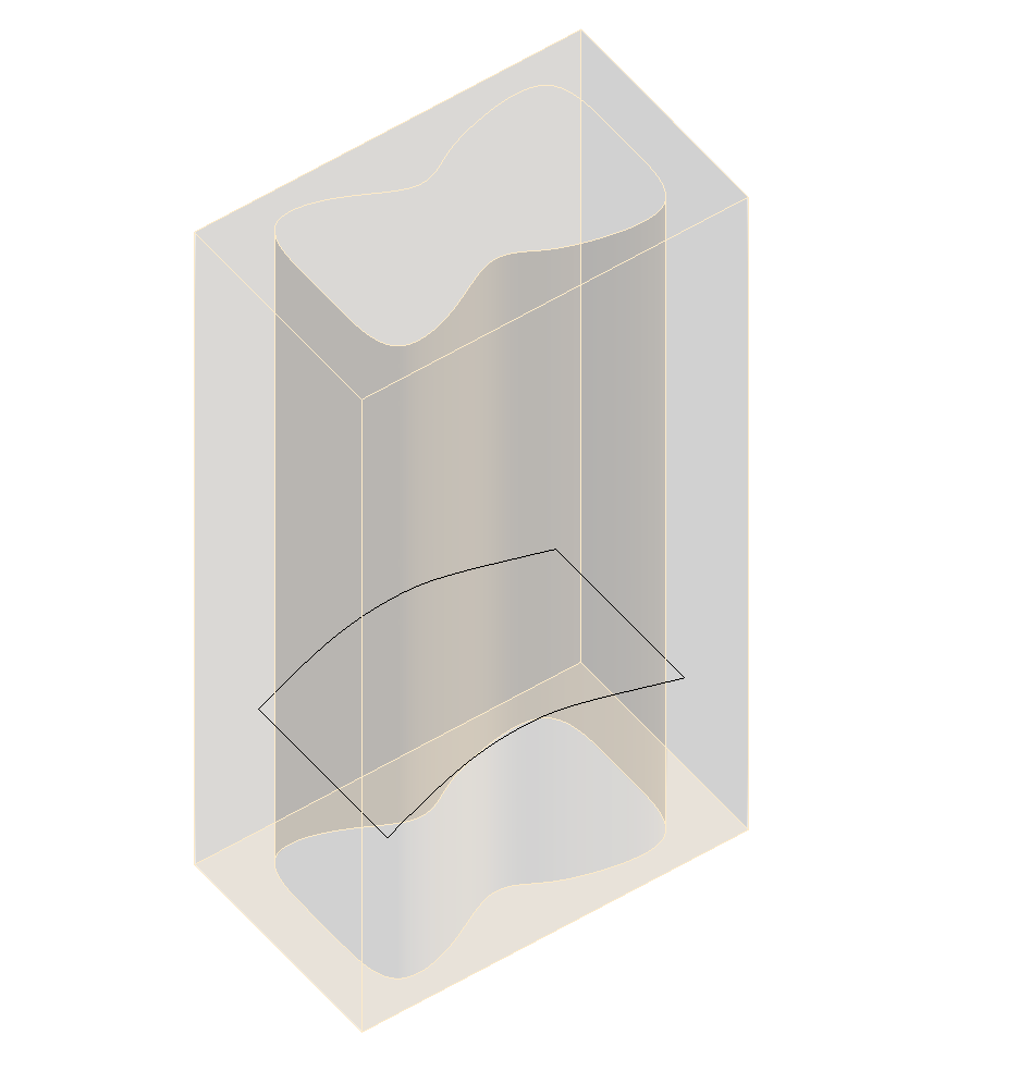

Hello, I am trying to create this roof in Revit using Rhino.Inside. The surface was created in Rhino using SubD then converted to surface. It has curvature in one direction, the longer one. I want to use it as a base for panelling, insulation layers etc. I had some success, I created a loft with only the curvature defining curve, used that to create a mass in Revit. I used roof by face to create a roof. Then I created a void mass, in grasshopper, to cut out the final shape of the roof. The problem is this only works with normal roofs. I want to create panels on top. Curtain system by face cannot be cut with the void mass. Attaching the grasshopper file, geometry internalized, and the Revit file.
car_showroom_rhinoinsde.gh (50.2 KB)
Revit file is too large to upload
