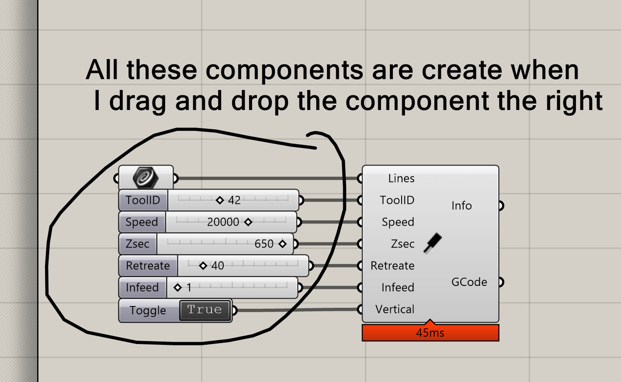

I have a small issue with this code you referenced:
List<Guid> guids = new List<Guid>();
foreach (Grasshopper.Kernel.IGH_Param param in base.Params.Input)
foreach (IGH_Param source in param.Sources)
guids.Add(source.Attributes.Parent.InstanceGuid);
I create a grasshopper component, but within this component I create some more components as input. The moment I use this option for my case Parent.InstanceGuid return null.
I create additional input components like this:
public override void AddedToDocument(GH_Document document)
base.AddedToDocument(document);
//Add Curve
Curve[] lines = new Curve[] {
(new Line(new Point3d(200,-200,300),new Point3d(200,-200,400))).ToNurbsCurve()
int[] recID = new int[] { 0 };
for (int i = 0; i < recID.Length; i++)
Grasshopper.Kernel.Parameters.Param_Curve ri = Params.Input[recID[i]] as Grasshopper.Kernel.Parameters.Param_Curve;
if (ri == null || ri.SourceCount > 0 || ri.PersistentDataCount > 0) return;
Attributes.PerformLayout();
int x = (int)ri.Attributes.Pivot.X - 225;
int y = (int)ri.Attributes.Pivot.Y;
IGH_Param lineParam = new Grasshopper.Kernel.Parameters.Param_Curve();
lineParam.AddVolatileData(new Grasshopper.Kernel.Data.GH_Path(0), 0, lines[i]);
lineParam.CreateAttributes();
lineParam.Attributes.Pivot = new System.Drawing.PointF(x, y);
lineParam.Attributes.ExpireLayout();
document.AddObject(lineParam, false);
ri.AddSource(lineParam);

I assume that c# component runs the code to retrieve guids before all these components are created.
So the question is when do I need to call this function, so that the returned guids are not null?
Oh yes, I have seen that the code returns null for e.g. sliders. I reduced the problem to a simple slider.
I made it work (very simple, I wasn’t able to quickly rebuild your building solution) by using this code from this post from rolf:
// Checking the first Input param (at index = 0)
var param = Component.Params.Input[0];
if (param.Sources.Count < 1)
return; // No source was connected to inport
A = param.Sources[0].InstanceGuid; // Output the Guid
which will give you the correct GUID id
I guess you need to loop through them as you set the inputs yourself.

@Petras_Vestartas how did you make align components on the left with the inputs on the right? Did you code it?
int x = (int)ni.Attributes.Pivot.X - 250;
int y = (int)ni.Attributes.Pivot.Y - 10;
I am having a hard time to make them align. Any advice?
Exactly, and the pivot point is the alignment point

It works perfect. Thanks for the explanation!
