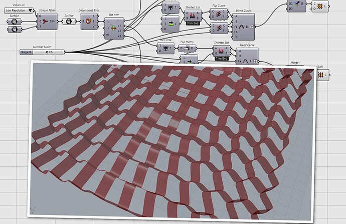

Hello
here a first try, there are still holes but I think the logic could be used to make network surfaces, or extract curves in UV …
The logic is just to blend the edges of mirror.
Panels_to_Geometry_LD.gh (1.2 MB)
And here a version that generate a surface
Panels_to_Geometry_LD_v2.gh (1.2 MB)
Hi Laurent,
Thank you so much … and quite surprised it’s pretty fast. I can definitely extent on this. Nice touch with the ‘blend curve’ to define smoothing the edges!
You could use the second script to make a whole surface using Network Surface that strangely didn’t work for me yesterday!
Then blend surface in Rhinoceros
Then Network surface for the corners
With some symmetries.
Or you can fill the holes of first script using Rhinoceros

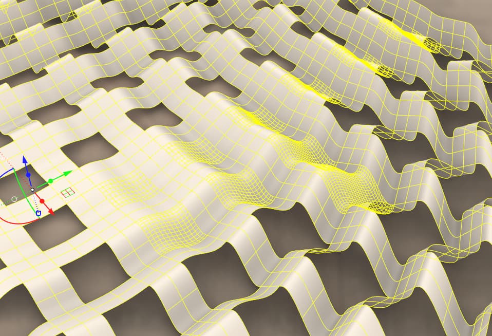

Hi Laurent,
I figured it out using your first script as the basis. As you can see in attached file I use 2 x Ruled Surfaces + 1 x Edge Surface instead of Loft. So close as you suggest in your last reply. This gives me actually want I hoped to achieve and you definitely set me up the right direction.
Hope it will help other in the future.
PS: nice looking shiny material. Care to share how you made this?
PPS: I also tried Network Surface but failed as well. Maybe I will give it another try later today, as I think a single surface instead of multiple might to useful. I am not aware of a way to ‘join’ multiples surface into one, and still have it as a single surface, instead it will most likely become en Open Brep
Panels_to_Geometry_LD_v4.gh (1.2 MB)
I’ll see if I can clean it up a bit, but for now it does the job
Here a file with only one surface without the border/frame, there is also the material.
