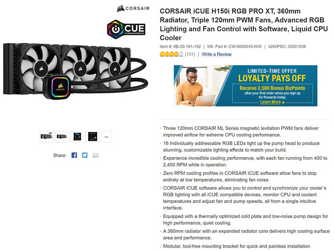

David,
I did not use my system with an air cooler before installing the liquid cooling system. I built my own system so I could choose a good liquid cooling system. For the liquid cooling system I used this Corsair cooler:
The cooling head is the small square in the picture. It is tiny compared to competitive air coolers. Thus there is low stress on the CPU when you move your system around. I have used this on multiple of my systems with 18-core CPU for years with no problems.
Regards, Terry.
