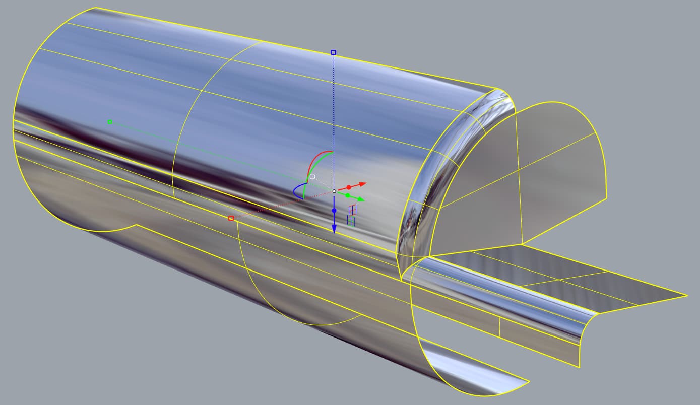

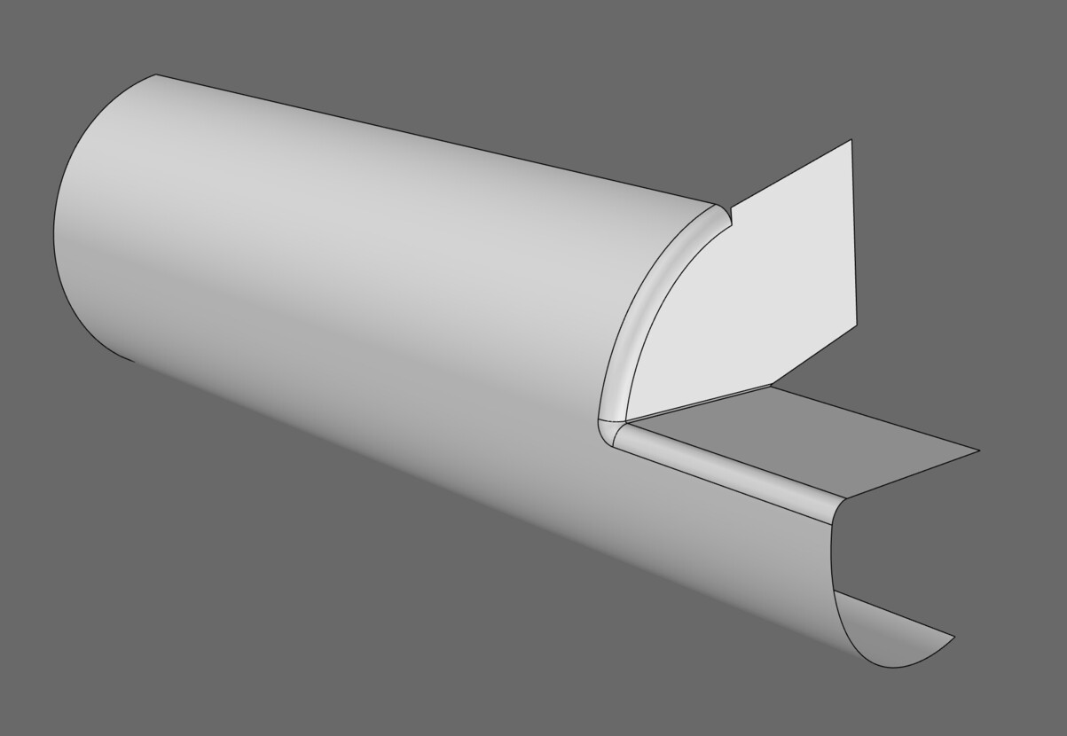

Hi!
How to fix this cap?
I tried several surface tools but I couldn’t get good results…
FILLET FIX.3dm (235.5 KB)
Other corners are made with solidfillet…
Thanks :slight_smile:
You can either extend the three adjacent surfaces until they all intersect each other, and then try to trim them. You might need to untrim the flatter surface of the three, instead of extending it.
Alternatively, you could try NetworkSrf.

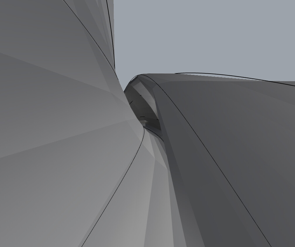

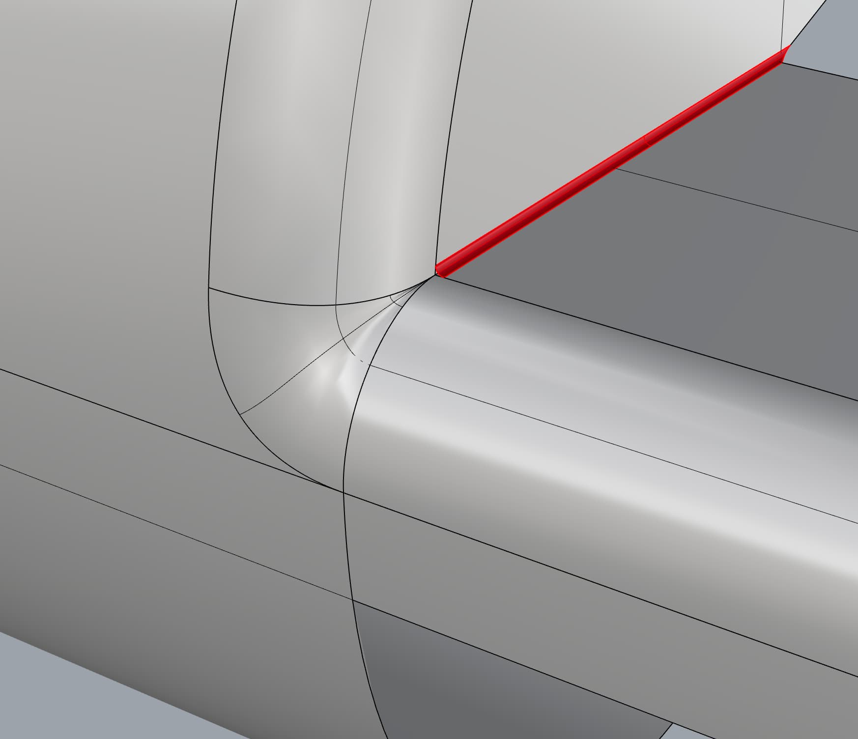

Here’s how it looks after using NetworkSrf:
Hi!
This is what I get…
I think that sucks, but…
Maybe I don’t know all the command settings, but the only way I got good result is to div edges,
extract isocurves and blend those together.
Then use _NetworkSrf.

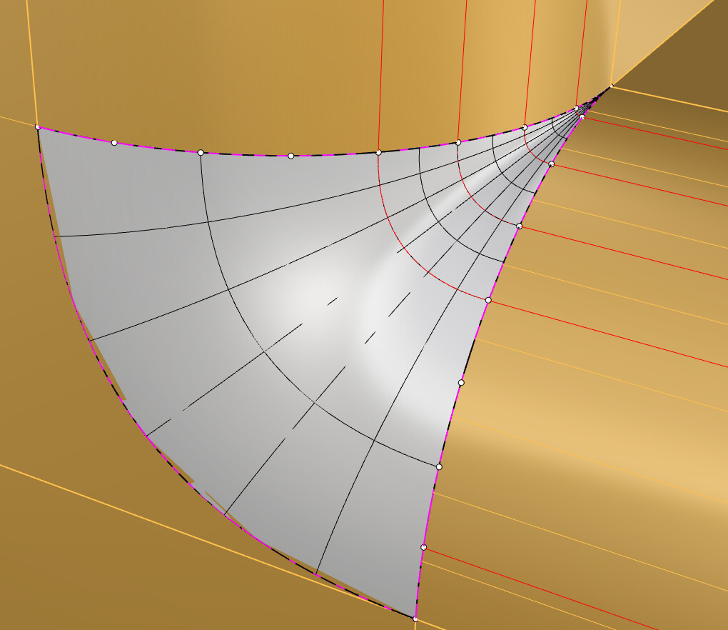

The first method I mentioned above works also, but instead of trimming the bigger, untrimmed surface, I simply got rid of it. It was beyond saving. I rebuilt it with a two-rail-sweep of duplicated boundary edge curves.
FILLET FIX 2.3dm (2.6 MB)

blend surface and match multiple.
sweep1 actually also produces a good result but the surface continuity is not very accurate, if that is important for milling at all at this stage.

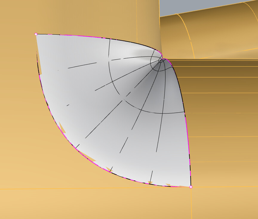

I tried sweep1 also earlier and now again.
My result is not so good…
I got same kind of results with many surface tools (blend surface, patch, sweep 1/2, EdgeSrf, NetworkSrf…
Yes, I can maybe live with that (until I export solid to manufacturer) but I think it is not high quality surface. Rhino is awesome software and I really love it but it should not be so difficult to make good fillets… It’s not all about this exact fillet (because there is hundreds of more same kind of), maybe I just want to hear if there is already a tool, or if it is impossible to develope easy high quality fillets…

did you try blend surface as in the example posted above?
So what’s wrong with this?
FILLET FIX.3dm (231.7 KB)

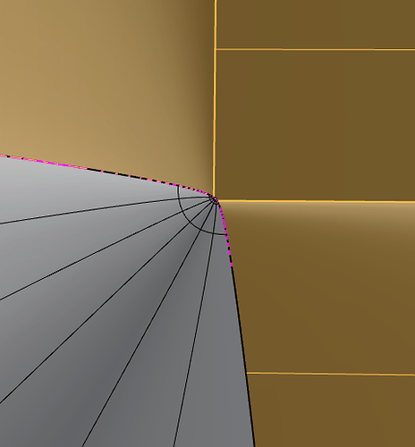

Martin: That is possible option (without third curved edge). and yes, I can do it here like that.
BUT, the case is not this exact corner.
like I tried to say, I think it is weird that there is not (what I know with 15y Rhino experience) tool to make good quality fillet/patch/cap from 3 curved edges like in the example without a lot of extra work.
Encephalon: Yes I tried blendsrf and It made best result. Anyway it wanted to move lower edge.
Sample edge was made with blendcrv and then cut.

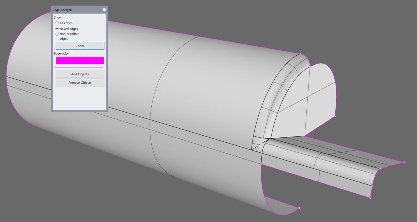

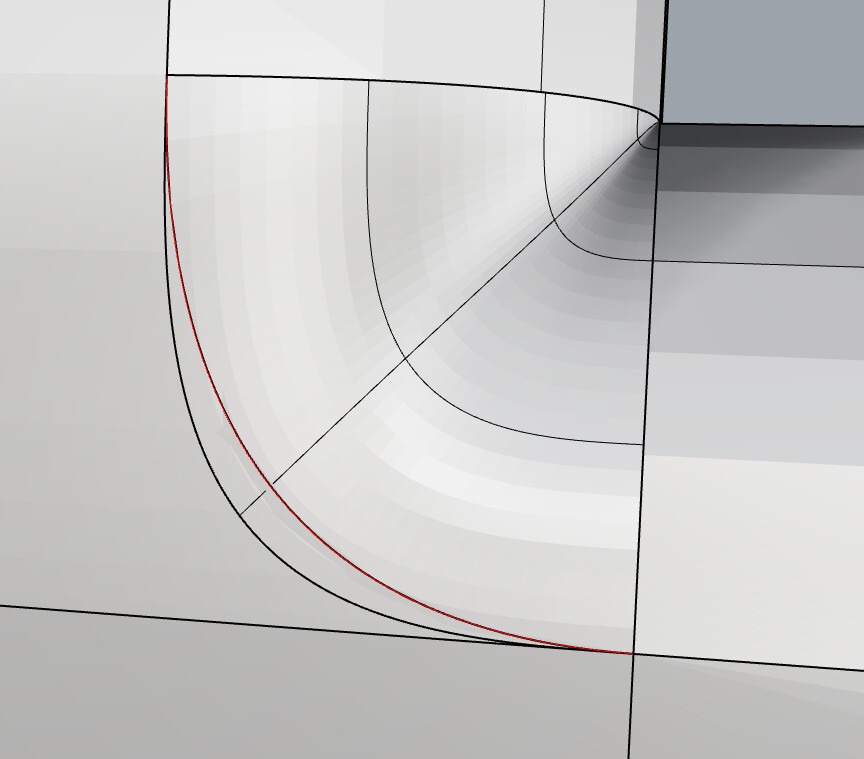

i would do:
_loft with option start / end tangent
_changeDegree 5/5
_matchSrf (position for the missing edge - refine yes)
_matchSrf (tangent for all edges refine yes)
FILLET FIX_tp.3dm (220.7 KB)
BUT
i would recommend to do an additional minimal fillet in the concave edge (red)
this will allow a more proper solution and avoid a triangular surface.

_patch
we are talking about a 0.5x0.5x1.0 mm surface and not a detail of a car…
in real live, we will not see the difference between a perfect surface (that small) and quite _patch - i doubt that the difference can be produced or is within production tolerance.
