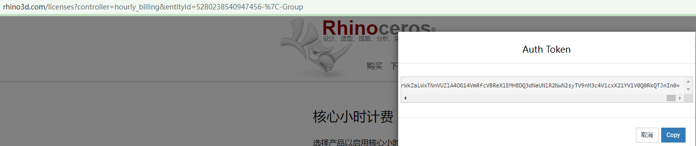

I setup a core hour billing using my own token two months ago. one month later, I changed the RHINO_TOKEN to use another team’s billing account. but today, I found the charges are still going to my account.
Further more, I have two identical servers both running same code. I changed both the RHINO_TOKENs to another team’s new token one month ago. last night, I shutdown my own billing token. today, I found the rhino.compute services refused to start up due to a HRESULT E_FAIL of COM component in one of the server. but the other can restart the service without problem.
My question is: how should I change the core hour billing from one account to another? is there anything I missed here other than changing the RHINO_TOKEN?

Can you double check that Rhino is reading the updated token? Start Rhino.exe again, run EditPythonScript and then run the script below to print the token.
import os
print(os.environ.get('RHINO_TOKEN'))
It is indeed reading the updated token. My old token ends up with “QTJnIn0=”, while the updated token ends up with “OWp3In0=”.
How are you setting the environment variable and how and you running Rhino.exe?

Thank you. I’ve been trying to reproduce the behaviour you’re seeing, but I’m not having any luck. I was however seeing some odd behaviour (not exactly the same as your problem) when launching Rhino from the same PowerShell prompt used to set the environment variable, so I was curious to know how you were doing it.
For anyone else reading along… in this case the RHINO_TOKEN environment variable was set at both the user and machine levels, with the user-level variable (the old token) taking precedence.
