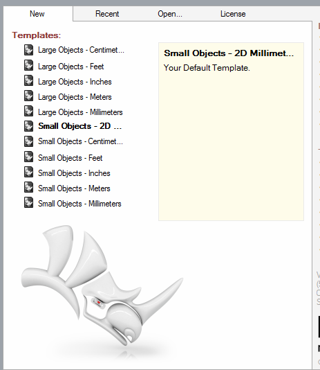

If you are using this layer structure all the time or frequently, you can make a template file and save that then open it on startup.

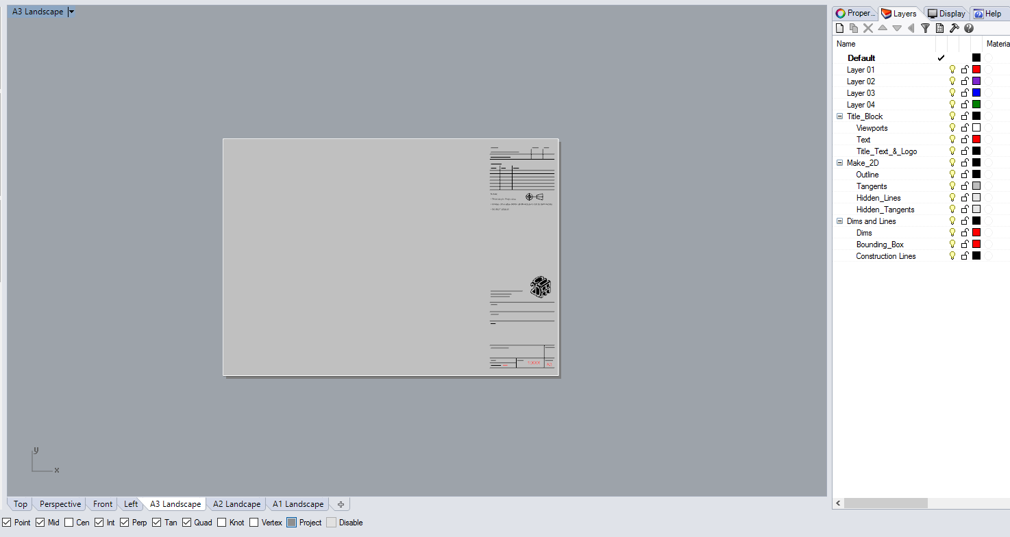

I don’t think Mac Rhino has layouts yet, it didn’t when I was trialling it for a year or so but it’s really helpful using templates. Set your standard template which you use as the default and it will always open with that.
Yes we do … now, since a few builds …
Behind my Layout screen is how the template files look on Rhino for Mac. Not everyone on the Rhino for Mac category has used Rhino for Windows, so showing Windows images may be a bit confusing. FWIW
