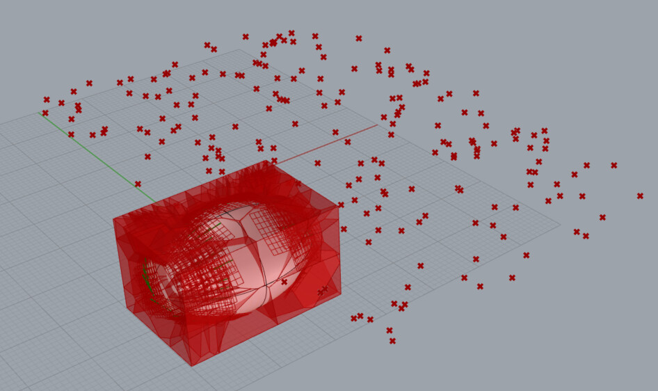

Converting Brep to Mesh (GH file attached)
Ah, you are running into an error in Dendro. This happens when a curve length going into the Dendro vCurve component is shorter than your curve radius input.
More info on the error: Dendro solution exception error
Fix for your definition is attached
