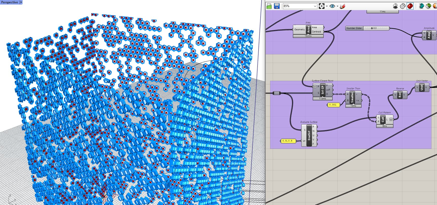

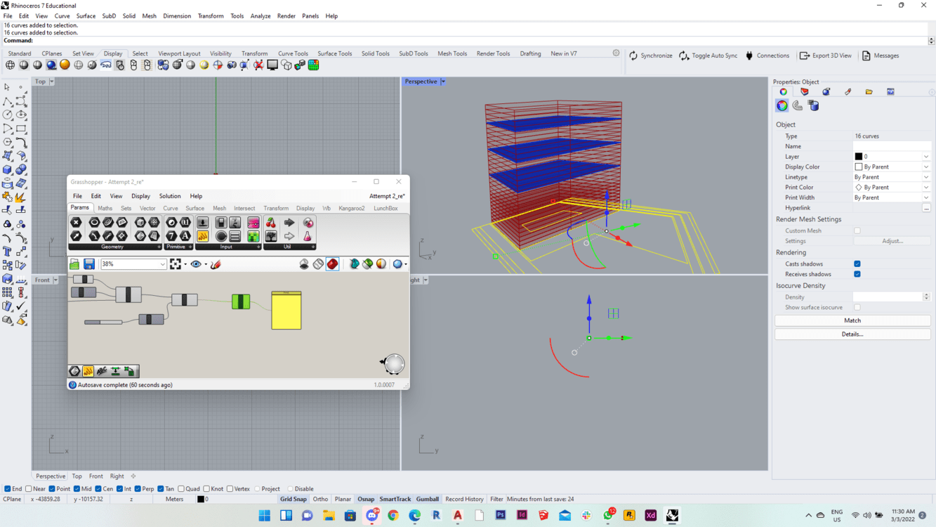

I am having trouble with my contour command as only 3 breps out of the 20 are closed. Not sure how to resolve this.
would you mind attaching the GH file with internalized geometries? ![]()
It seems that the breps are all closed now after i restarted rhino and grasshopper 2x. Is this a bug i should be concerned with?

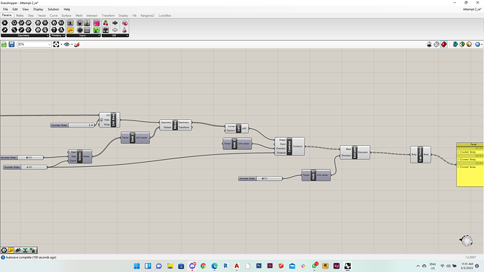

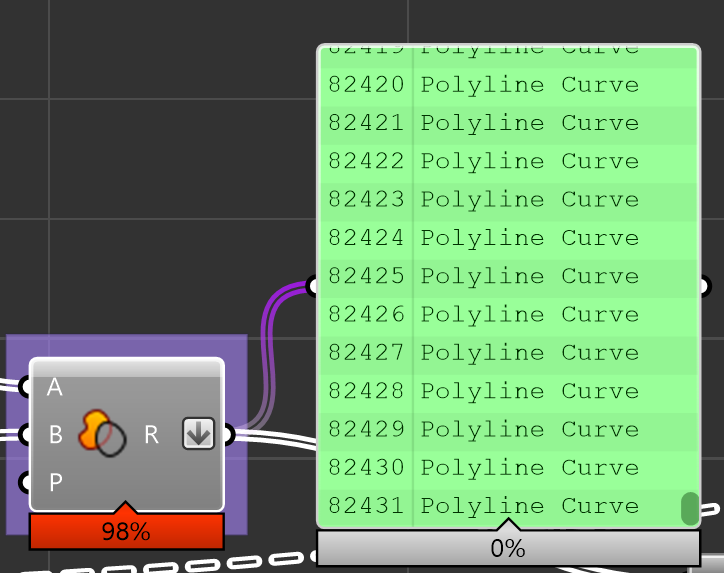

No problem! It seems you have some troubles with your tree structure, in the facade script. You have 82431 curves at some point…
I am still new to this as the script I am modeling is from a YouTube tutorial. Is the responsible for why my pattern in the facade is selecting the whole geometry?
sorry I dont quite understand your question
For some reason, My pattern has been selecting the whole geometry as one pattern instead of a select few. Is it because i have so many curves in my existing curves?

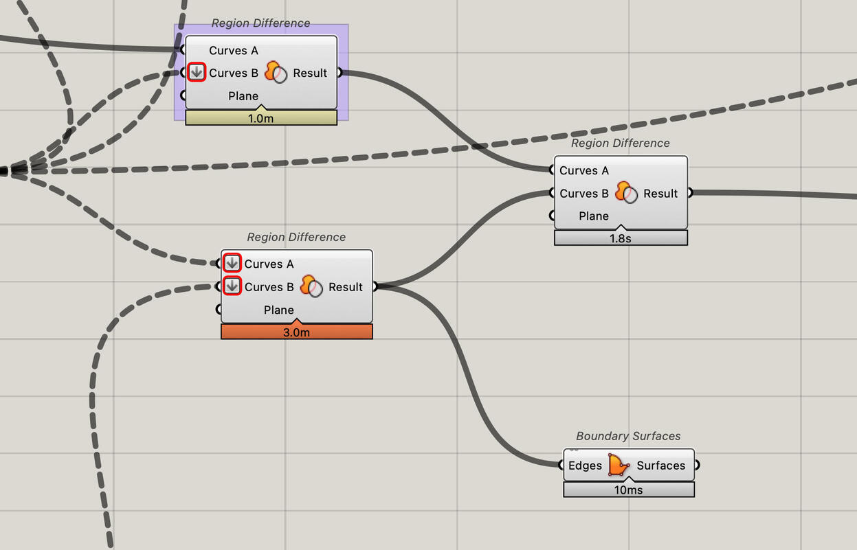

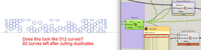

You are not getting the results your are expecting because you are inputting DataTrees to the Region Difference components (note the dashed lines).
If you flatten these inputs, you will get the results you expect but your file that was slow to solve gets even slower.

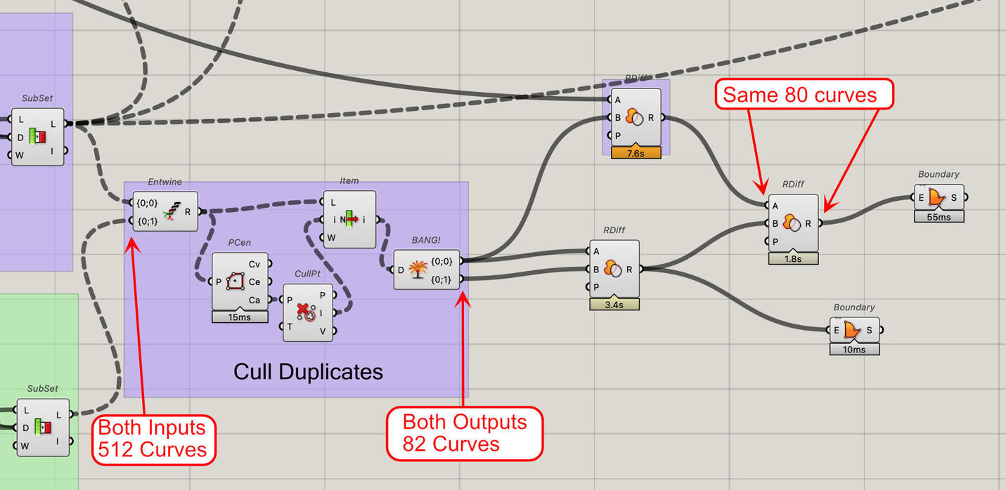

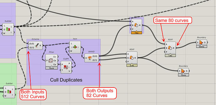

If you examine the inputs to the Region Difference components you will see that there are many duplicated curves:
After culling these duplicate curves, things work as expected in seconds instead of minutes:
Also note that the third Region Difference has no effect (80 curves at input A → same 80 curves at the output).

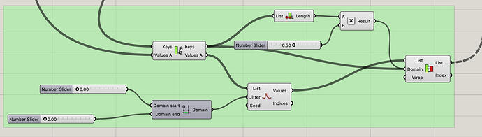

You had this identical code block 2 times in your file so I combined them into one block using trees:
Removed the code for culling duplicates as it is not needed now.

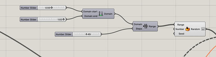

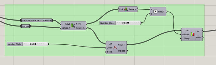

Also changed this part of your code that generates the random numbers for your scale factors:
To this:
Even though the input to the Random is named “Range”, if you hover over it you can see from the pop-up that it is expecting a Domain.

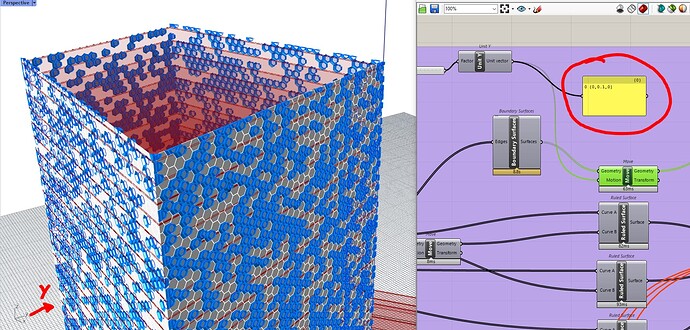

So the script for my facades have been linked successfully, however my windows seem to be inverted outwards on certain facades of my building. I have no idea how to resolve this at all. And Just to make my model look neat, I have been trying to offset the facade slight away from the floors
it happens because the direction in which the cells are extruded is set to +Y, so all your curves are extruded in that direction
(this is taken from the top of your Def, but is the same for other areas)
Will a unit vector solve this issue on displaying my windows in the correct direction on all my facades?
this might work, but it’s a patch ![]()
Facade of Design updated_Re.gh (45.6 KB)
if you want the windows to be oriented in the opposite direction, just delete the Reverse Vector component here:
