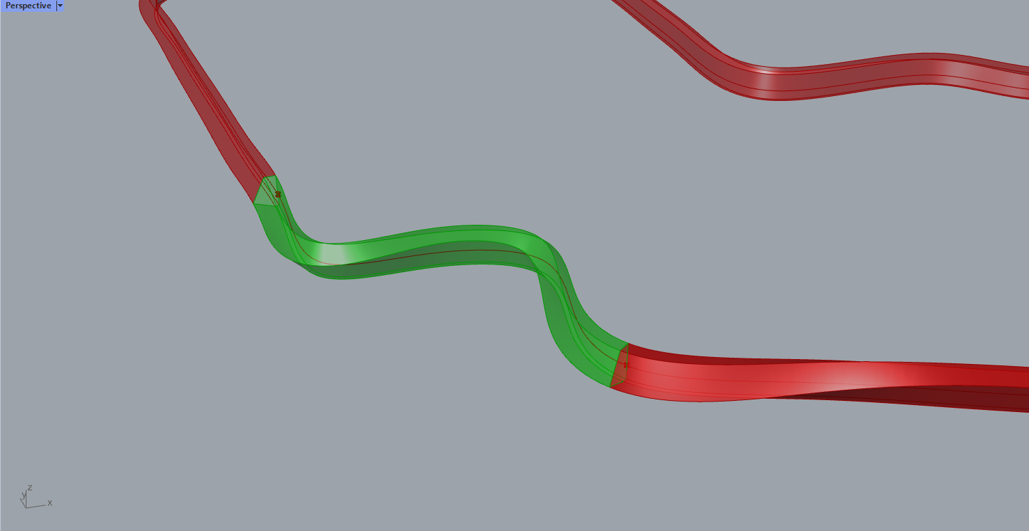

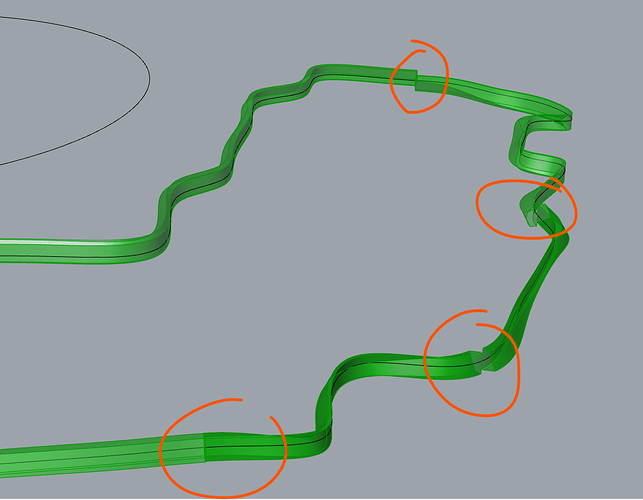

I was trying to create a continuous sweep profile with various sections. However, the result always have portion of the sweep in a different direction.

it’s a different approach. my seems broke the direction

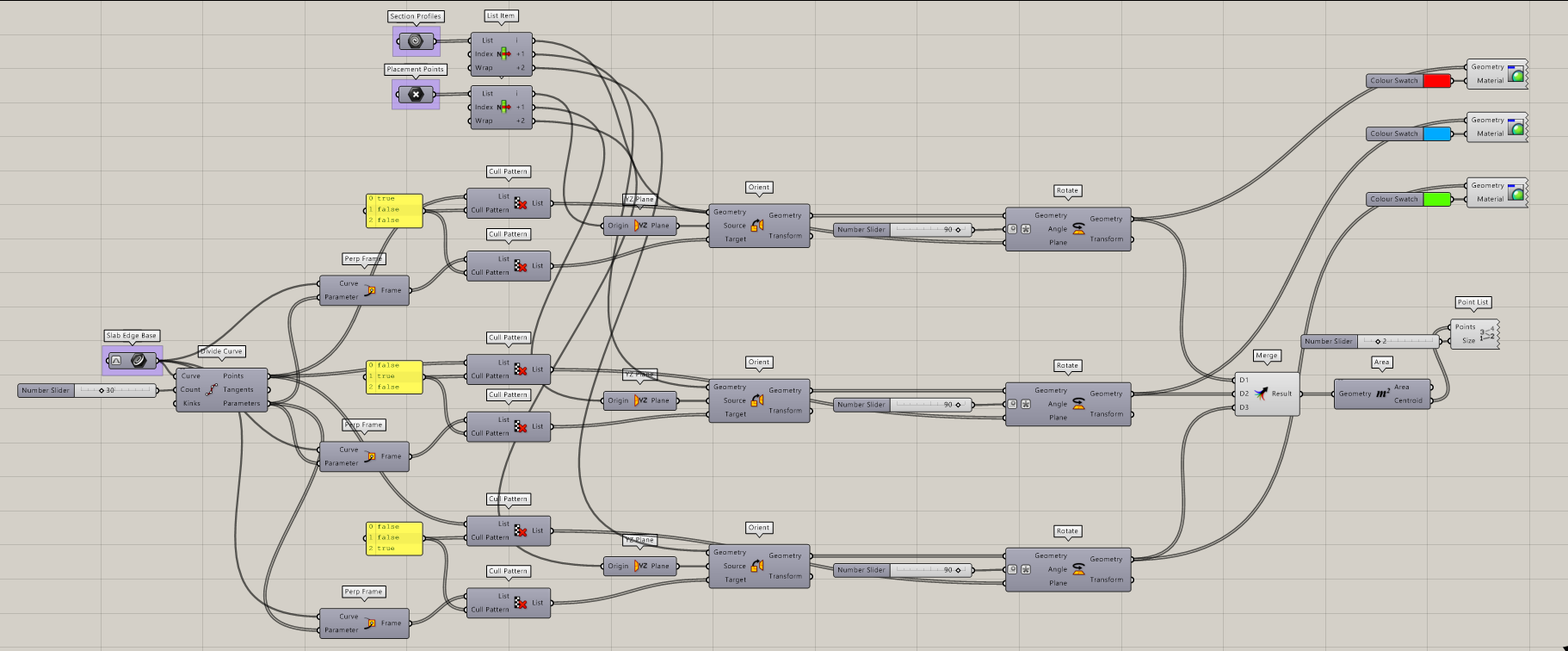

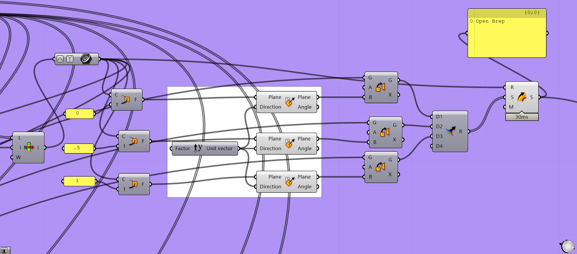

for the ones that are sweeping in a different direction, you can realign the plane to a new vector
SLAB GH_GL.gh (53.6 KB)
