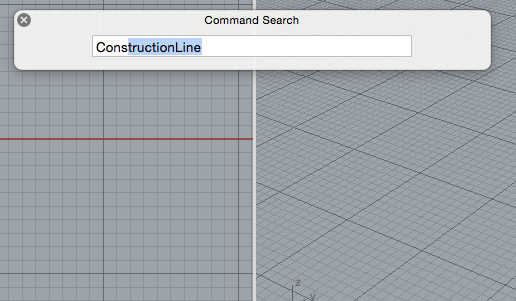

Open Rhino up again. Type ConstructionLine and it should autocomplete and work.
I finally managed to install your script but I’m getting no response. Do you see any problem with what I’ve set up here?

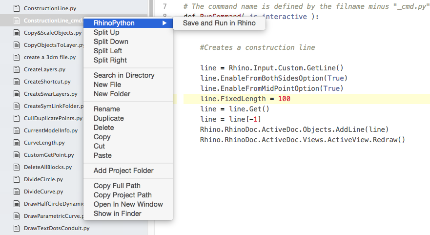

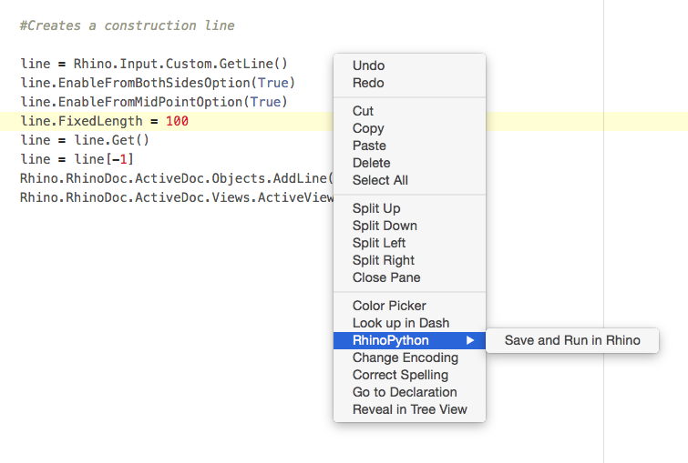

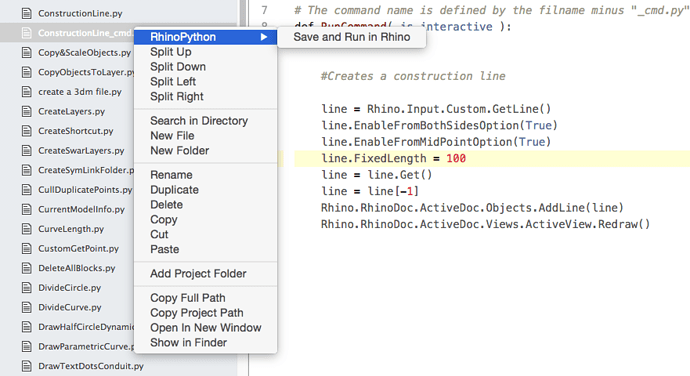

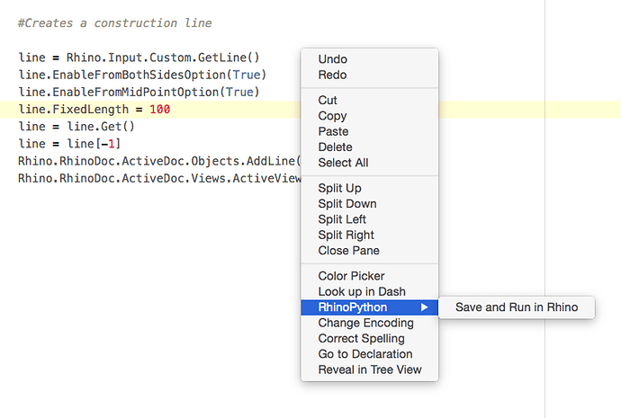

I only have 1 or 2 scripts tied to icons, like above. I find it way quicker to just right-click in Atom to run any script I have open there. Like this …
You can also run them from the Atom sidebar by right-clicking …

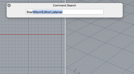

You do have to make sure Rhino is listening to Atom though, by running this command first …

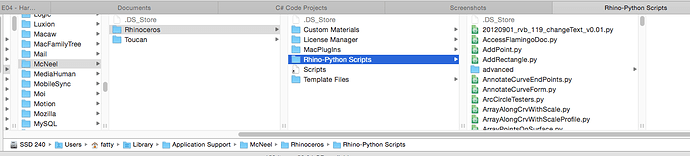

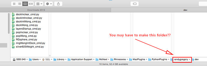

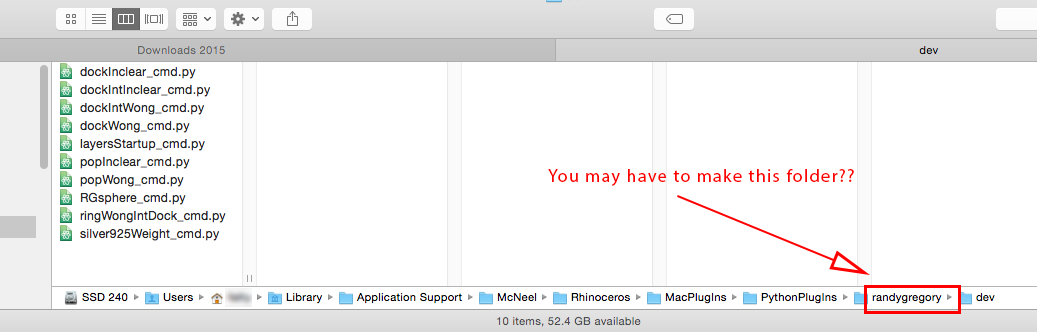

All python scripts that have the suffix _cmd after their name, like the ConstructionLine script above, means they are put in a special folder … It should be your name, not mine
I can’t find the page where this is explained, it was the old RhinoPython pages, where to put these scripts.
and can be run from the command line …

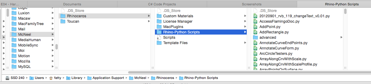

All regular scripts go here, my folder name is linked to the folder in my Dropbox with an alias. This is described in the post linked earlier. This way I have the same scripts at home and at my office.

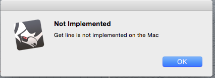

Now getting into the “GetLine” not working on a Mac, any ideas @pascal, @dan on how to get this implemented on a mac?
Code:
line = Rhino.Input.Custom.GetLine()
line.EnableFromBothSidesOption(True)
line.EnableFromMidPointOption(True)
line.FixedLength = 100
line = line.Get()
line = line[-1]
Rhino.RhinoDoc.ActiveDoc.Objects.AddLine(line)
Rhino.RhinoDoc.ActiveDoc.Views.ActiveView.Redraw()
GetLine is not working on my mac either. You need an
import Rhino
statement at the top of the script, but even with that, I get the error on mac and it works on Windows. Presumably, it is a bug, or I am overlooking somerthing… meantime here’s one that uses Rhinoscript syntax:
