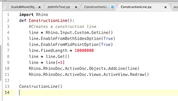

I am assuming it’s a bug. I had the import Rhino, I just didn’t copy it in my code block, I will next time.
You posted a script on another post about a week ago …
That had the error as well.
Here is the code from above …

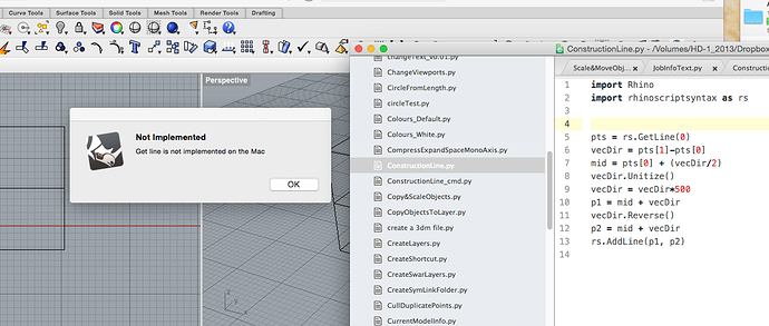

Does the RhinoscriptSyntax one actually work on mac?
I don’t think so, just checking.
Nope First this …
then this …
Off for a bit, I will check later. Happy Saturday @pascal
Thanks
http://mcneel.myjetbrains.com/youtrack/issue/MR-2394

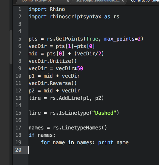

Meantime, let’s try rs.GetPoints()
import Rhino
pts = rs.GetPoints(True, max_points=2)
vecDir = pts[1]-pts[0]
mid = pts[0] + (vecDir/2)
vecDir.Unitize()
vecDir = vecDir*500
p1 = mid + vecDir
vecDir.Reverse()
p2 = mid + vecDir
rs.AddLine(p1, p2)
That works, thanks. So all you’re doing is setting the direction by the points.

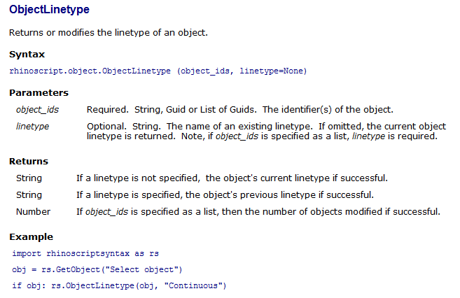

Not sure how to get the line “Dashed”. I can get LineTypeNames …
Not sure how to get the line to change to “Dashed” ?
Any ideas how to change LineType, if possible?
Not much time here today to look through RhinoCOmmon.
Hi Randy,
You probably want to look at rs.ObjectLinetype(obj_ID, linetype_name) and perhaps rs.ObjectLinetypeSource()…
I’ll let you run with that, let me know if you need more help… :smile:
–Mitch
Thanks Mitch,
Object Linetype should work. I will give it a try in a bit.
Sometimes looking in all the wrong places, didn’t see anything under Line or LineType !
«Randy
Yeah, linetype is an object property, hence it’s under objects… Otherwise using the search tab with “linetype” finds it.
