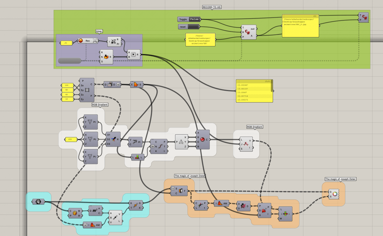

This is the result of moving a colour field pattern to a surface and recording it to a hard drive without a slider animation. I have limited contribution, credit has to go to the brilliant joseph_oster and ben_benedict who provided most of the difficult parts. It proves to be much harder to project colour fields to surface areas than simply project curves. The solution to transfer individual frames directly to a folder on your HD is way better than using a slider ( if one wants to keep the data low).
This might be useful for some so I feel this needs to be out there.
XONG_2021_Jun25c.gh (30.3 KB)
