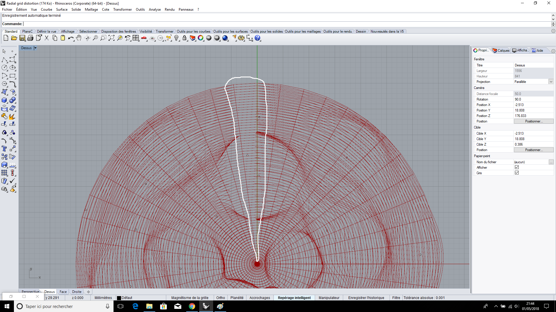

Hi Tim, thank you for trying ! This is not the result i expect as you can imagine. I’m wondering if it could be possible by drawing lines as you can see on this picture (in white) and then loft it from both grids. But I don’t know how to proceed…
Donā€˜t understand what you mean?!
