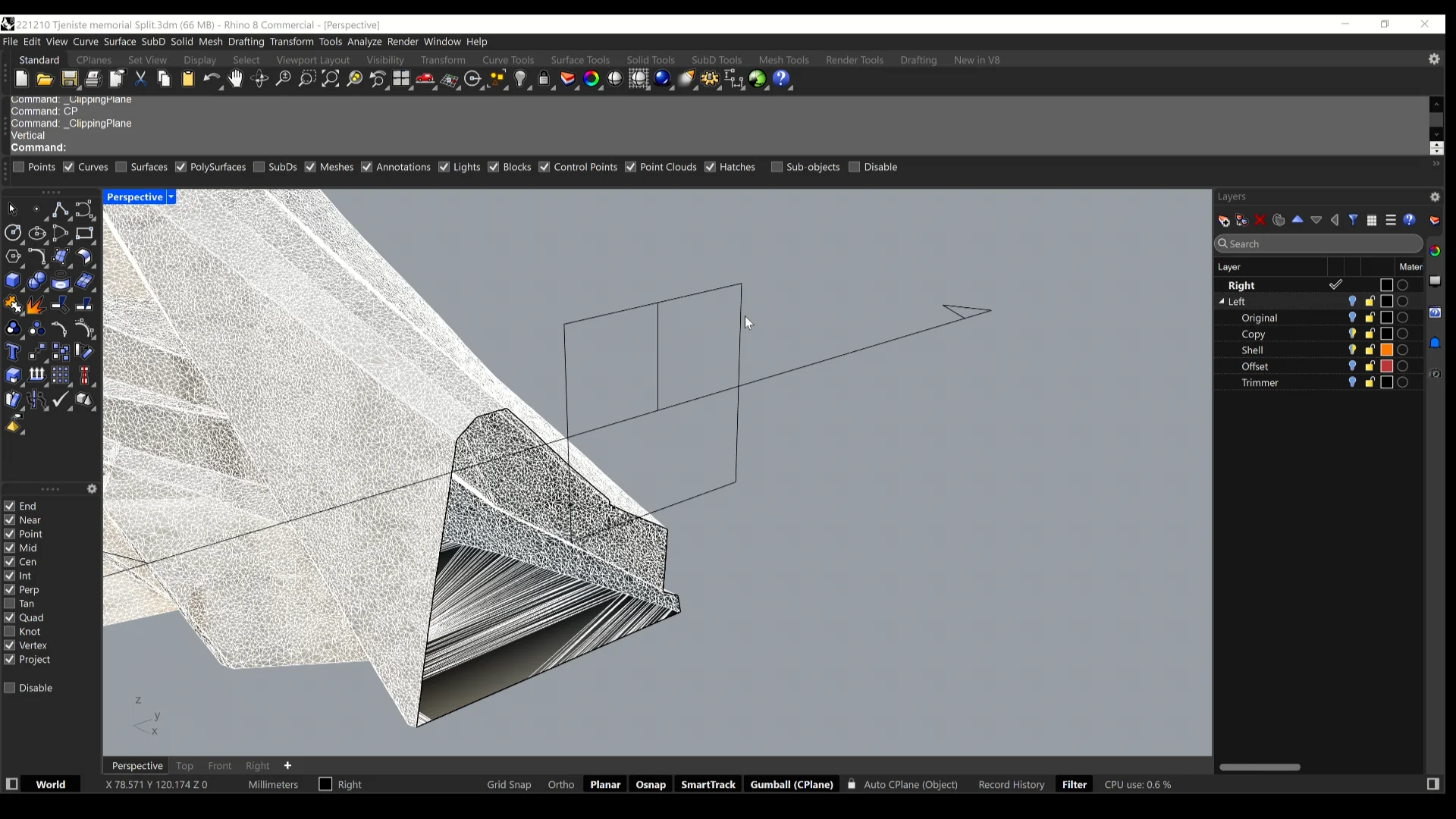

I was running into a weird situation where I couldn’t select the clipping plane. First I couldn’t figure out what kind of object the clipping plane was so I was just trying to turn on everyting one by one and trying to select the clipping plane. It seems like Rhino now disables the selection filter every 4th time you try to select something you cannot select. My questions:
  1. Is the automatic disabling of the selection filter expected behaviour?
  2. Is there a reason why is there nothing in the selection filter to only select clipping planes? I’d expect anything that can be an object in the rhino environment would be able to be filtered.

I don’t see the “Others” category in the selection filter? Have a look at what I see on the video
Edit: It seems like “Others” was there in Rhino 7 but not in Rhino 8 anymore. I was wondering why this felt so weird that I run into this problem for the first time.
