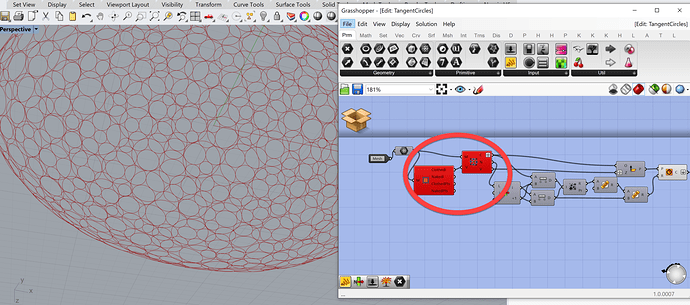

Hi Daniel
I am trying to use the definition you posted to build circle packing with fixed radiuses on a sphere. Running the algorithm, I receive multiple errors, as you see in the below picture, and if I give it a new mesh such as a sphere, it doesn’t produce a compact suitable circle packing. Could you please help me to fix this problem?
Thank you in advance
Hi @hooshmandmehrnaz
I can’t tell your problem from the screenshots.
For keeping points on a sphere though, I find it generally works better to use length goals keeping them at the same distance from an anchored point, instead of meshing the sphere and keeping them on that.

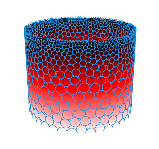

Hey @DanielPiker !
I have been following some of your posts on circle packing and it has been of great help. I wanted to get something like your brazilnut on a 3D mesh where the bigger circles are the bottom and the smaller ones are packed at the top. Also if it’s possible to control their radius as well. Could you help me figure it out? I would really appreciate it. Thanks.
Hi @anagha.bnca,
Here’s an example.
The trick is to create a mesh with vertex colours, and pass that to the ImageCircles component.
The mesh colours tell the circles what size to be when they are on that part of the mesh.
circle_sizegradient.gh (20.3 KB)
