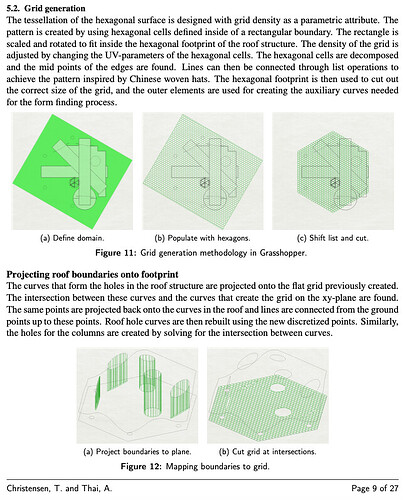

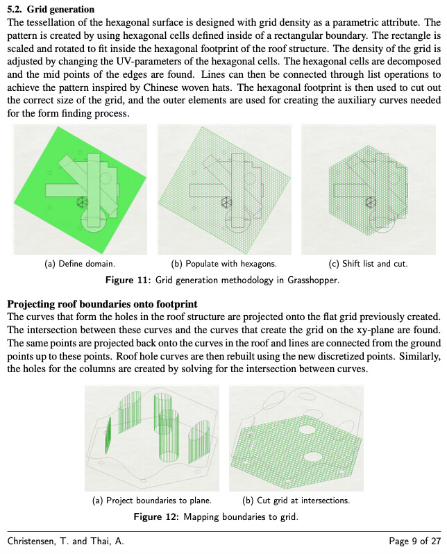

I would suggest checking out Frane Zilic’s images on the old GH-forum for great pointers on how to achieve the geometry using a kangaroo-based approach.
It helped me doing exactly that years ago for a small uni-project:
Hi. Here is the kangaroo part. It’s not exactly a minimal structure. It has a bit of catenary action to fit the concrete volumes. There is also a XY restriction to force the hexagons of the structure on plan view. This is the easy part.
What comes next is way harder. You have to create a continuous surface first, then create the beams using the surface. Sectioning the beams is the hard part. You first need to define where it can be split. Then you have to create a recursive process that creates a minimal bounding volume for the beam, analyze if the size fits the cnc working volume, if it’s OK then analyze the deviation of the beam fibers in relation to the minimal blank and keep the deviation less than 5 degrees. If it’s OK you use the beam, otherwise reduce one segment. If you have no more segments to remove, you move it to another process to start with a blank with one curvature. If that ins’t enough you have to start with a doubly curved blank.
