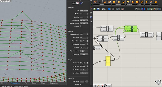

Can't weave two polylines in one continuous path after dispatch
Hi, I’ve been trying to weave two polylines into one continuous path for 3d printing purposes. I have a feeling that issue is coming from the weave’ pattern but I can’t find a way to fix - please helpppp
Thank you Felipe! However now they won’t merge at all in a continuous path :confused:

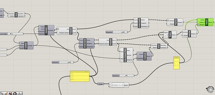

The output of the last weave is the set of layers as polylines, explode them and then flatten the vertices output, then create a new polyline with this flatten vertices, you get one continuous polyline.
Gcode-3D-Print-2.gh (19.3 KB)
