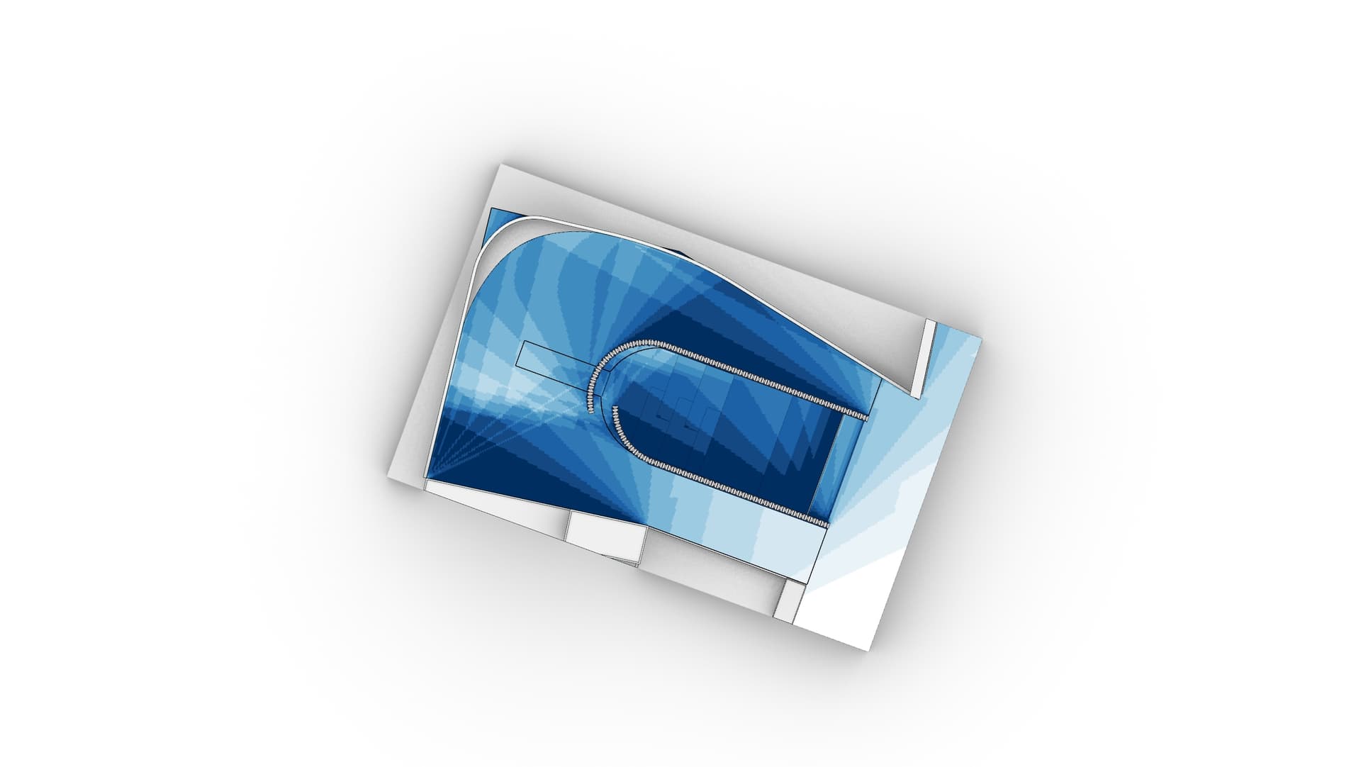

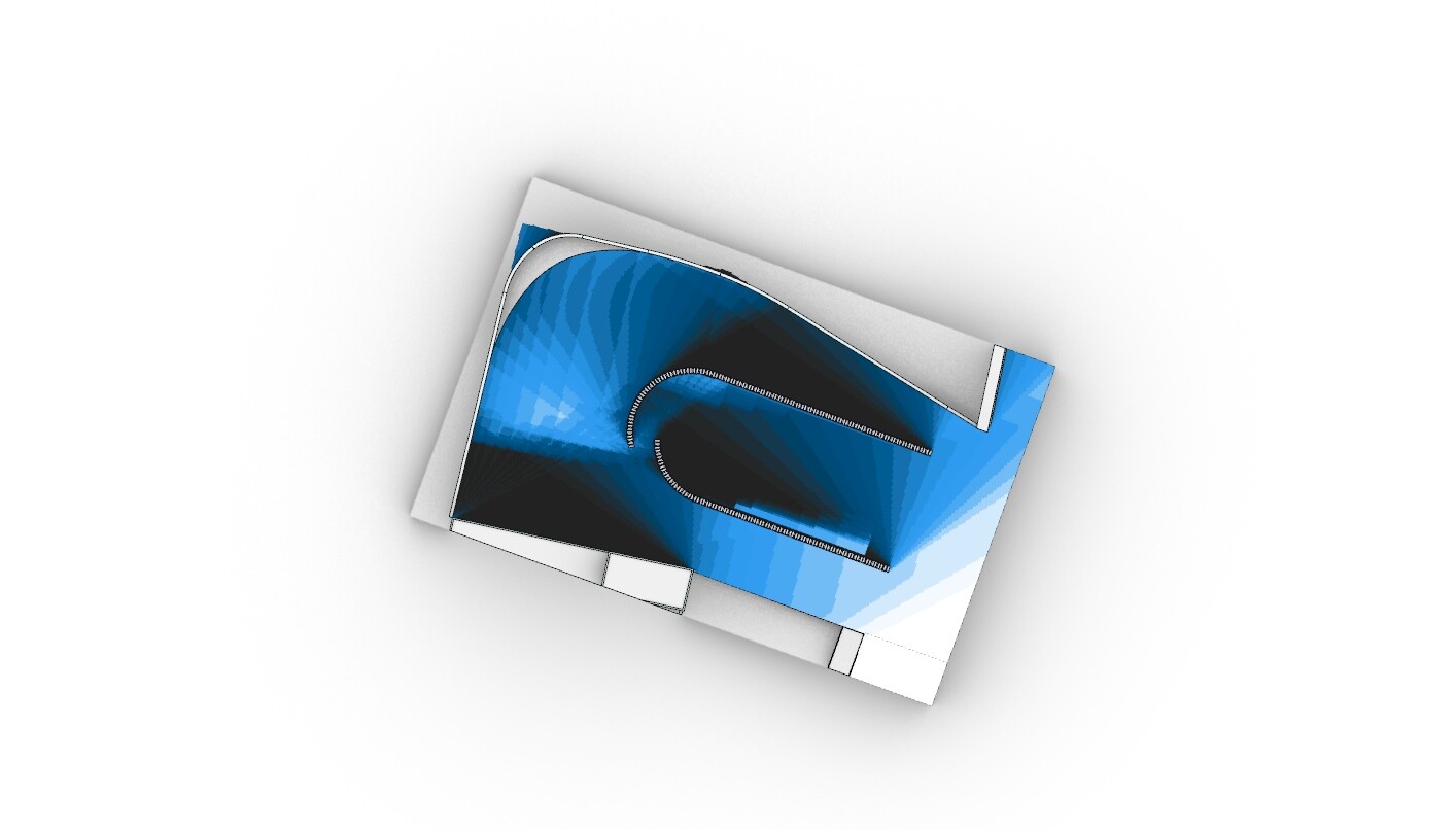

I wanted to share two images — one showing a shadow analysis I did using Ladybug, and another showing the same analysis recreated with Cyclops. The results match perfectly, which is great!

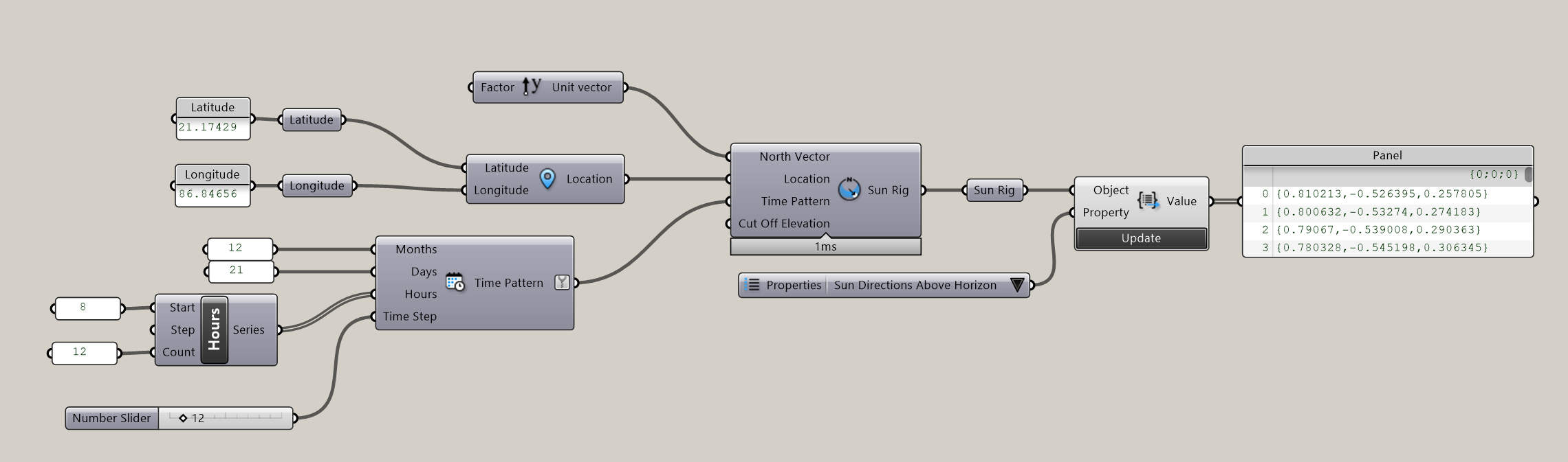

Hi Mario,
Glad you like it!
It would be tricky to run the analysis for individual 5 minute intervals. The sunlight hour analysis depends on the sun rig which depends on the time pattern and the time pattern can only sample full hours (with subdivision into multiple timesteps). But I can see the need of making this more flexible.
You can get the sun direction for each 5 min interval by setting the time step to 12 and then pulling the Sun Directions Above Horizon property from the sun rig.

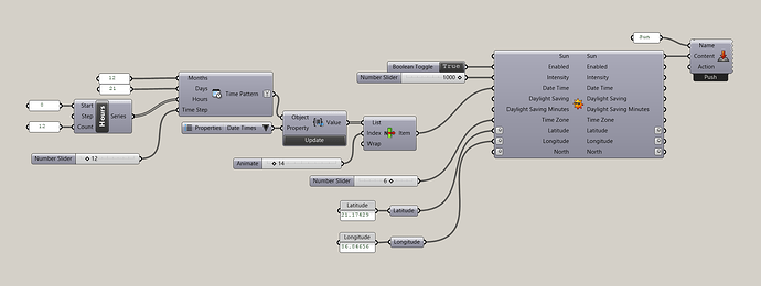

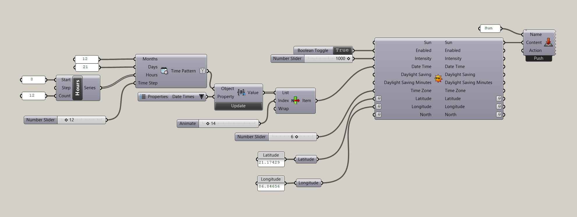

If you are in Rhino 8, then another option would be to animate the sunlight in Rhino instead. You can still use the Time Pattern to get the correct date times that you want to animate.
Something like this:
