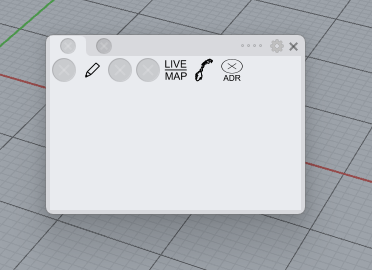

Here you can see what happens, on this button I can’t reach the top:
Which is a problem since saving the toolbar removed the old icons once again… :expressionless:
Only the new icons were saved + one old, while those who were the before are replaced with (X)'s…
I hope you can put some resources into the toolbar issues asap so we can start using V8 and preparing updating our tools in a reliable way.
I have not moved any of the SVG files, but I presume and need for the toolbar to save these icons in the rui file.

This seems to work OK here, great to have the ability to click OK on long scripts again, but I still loose all old icons when saving a toolbar file, only the once I replaced or added are saved. I don’t understand why this bug shall be able to last for weeks, it makes it impossible for me to use V8 right now. Every time I fix the toolbar the old icons that were working are lost again.
I can update the icons and close and open Rhino and they are all OK:
But if I save the toolbar and close and open Rhino then it looks like this:
So PLEASE fix the save bug as soon as possible.
