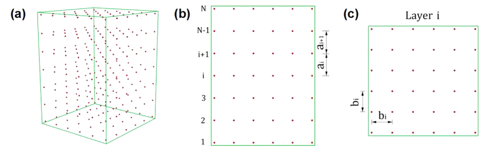

Hello I’m just new with Rhino and grasshopper program, just started it one week ago
I’m trying to make a porous structure where I can change the pore sizes so I could run a simulation
where I read the article form this link
" Design and Compressive Behavior of Controllable Irregular Porous Scaffolds: Based on Voronoi-Tessellation and for Additive Manufacturing"
However I tried to follow the steps got really got stuck at the start
the image is below, I tried using almost every voronoi cube in the forums but it didn’t work out so well when I tried to build a mesh, can anyone give me a little help here?
Thanks

However I tired this but some points like the below image makes it impossible to build a mesh
Basically I’m just stuck in the first part building a lattice points as below
I can’t find out how to make the below thing in grasshopper, tried to use evalutation but didn’t work out so well
