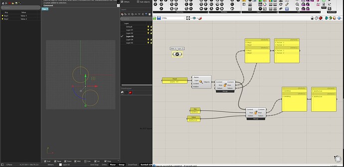

In the Beta 8.0.23264.9003, 2023-09-21, there’s a bug with the User Text component or at least, its behaviour was changed compared to how it worked previously. If I reference an object from Rhino (e.g. a curve) and pass it through a curve param before feeding it into a User Text component, the User Text fails to recognise the curve’s key/ value pairs.
Notice that the Key/Value pair is only dropped when I feed the curve through a curve param.
When I reference the curve with a curve primitive, it works as expected:
Notice that the bug also happens to points and surfaces that are put through their respective param component.

@Japhy I found the other another issue, previously I could add keys and values like so, but that doesn’t work anymore.
AddKeyValue with User Text.gh (15.9 KB)
In fact, I what I suspected turns out to be true, User Text to User Text even drops values in a script of mine (can’t reproduce in a clean document as of now).
So now this script of mine is entirely worthless :sob::
E: the curve/ point or surface passthrough issue is listed on Youtrack as enhancement, but it used to work this way for at least the past half year prior to the Beta. So in my eyes, it’s a regression.

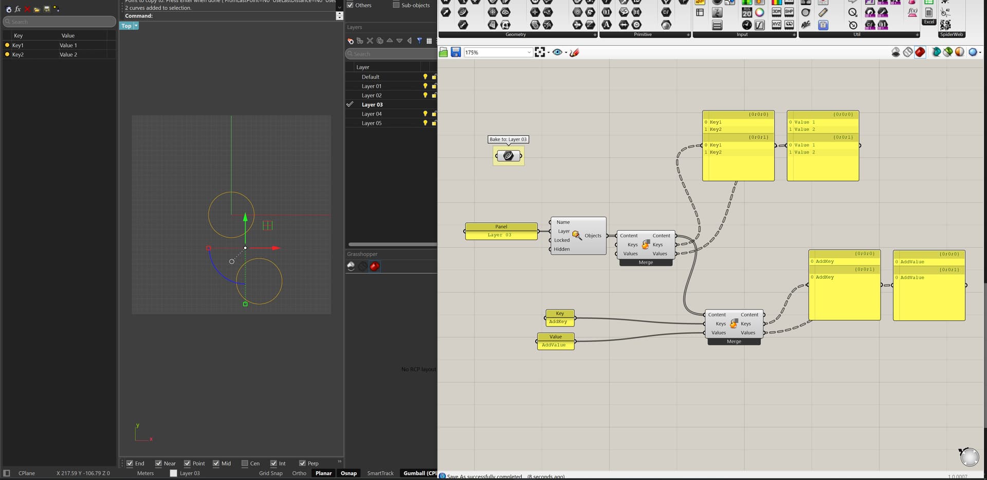

The point is, that I used to be able to use the geometry params to get User Text attributes from the Rhino document. But that’s not possible now. The Keys from both User Text components used to be the same prior to the Beta in the example below:
Basically, when I filtered my geometry either through regular components or through the Filter content/ Group Content, I could pass them through a geometry param and then feed it into a User Text component to get the User Text associated with the geometries from the Rhino document.
Earlier the Meta data from Rhino was not lost if I passed through a geometry param as input for a User Text component is what I am saying.
See the example below, earlier both curve params would output Referenced Geometry. Now the Query Model Objects outputs the specific curve type and no longer a Referenced Curve type.
Hence why the User Text component does not pick up the geometry’s User Text metadata from Rhino anymore since the Beta.
I know this is the case, because I had to go about converting points using a Deconstruct Point > Construct point to get the actual point positions to bake as User Text, so I could monitor which points changed position after baking.
Exactly, when the geometry inside a geometry param was “Referenced [Geometry Type]”, it would preserve Rhino Metadata for User Text.
This is an important nuance that I had been heavily utilising in my scripts.
Yes, and I am not requesting that to change. I just hope that the old behaviour can be restored, because that was perfect the way it was — and also in-line with the way you now describe how it ought to work. So I am not actually requesting the feature that geometry params preserve Metadata, it’s actually nice to be able to filter geometry, add Keys/ Values in Grasshopper to aid filtering and to then get rid of it post-filtering with a geometry param prior to baking the result. For instance, for ‘looping’ scripts that read from Rhino > modify the Rhino geometry in Grasshopper > bake the result to Rhino > Read back in to Grasshopper, it was perfect the way it was.
