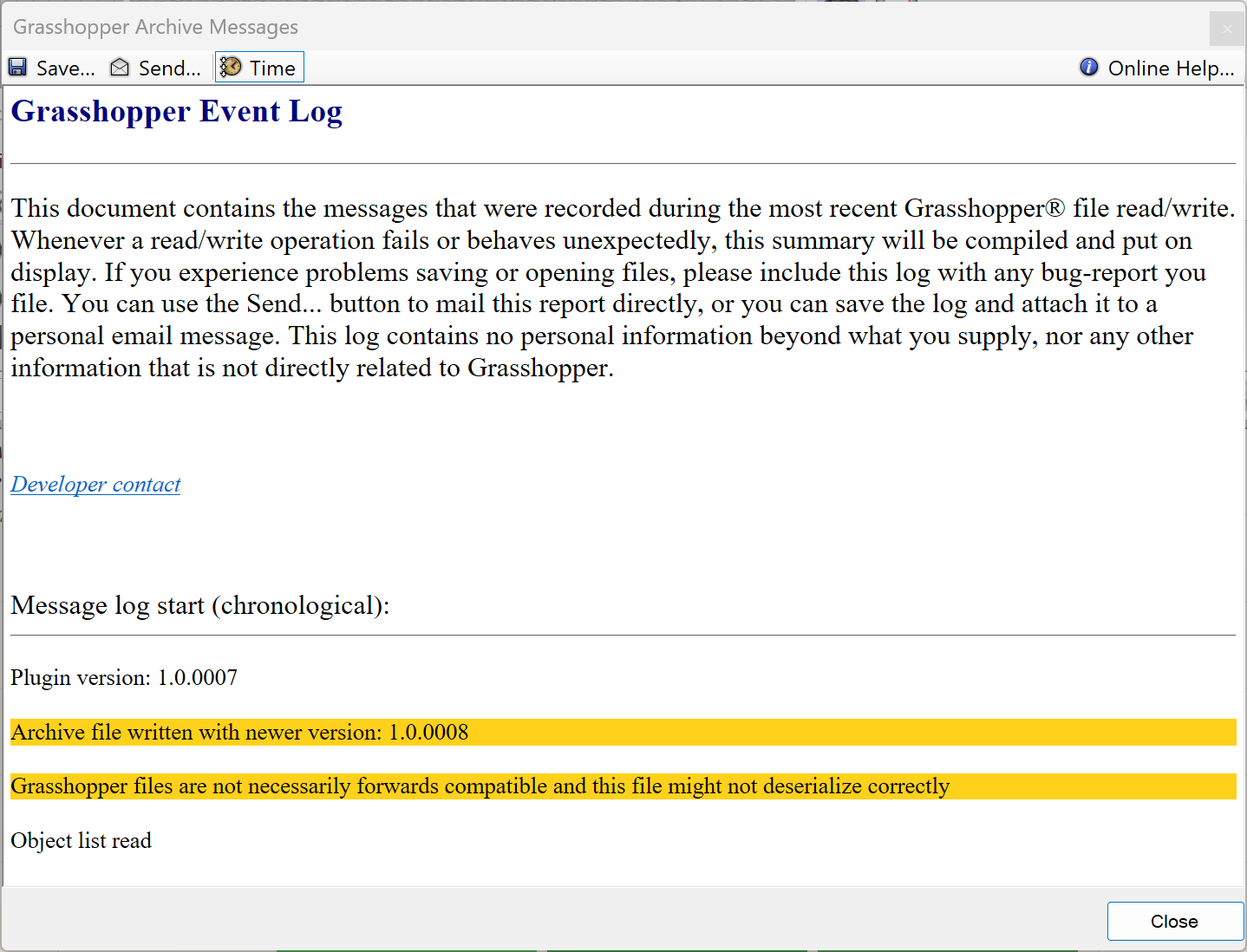

  • in 7, grasshopper, create a SubD param, set a SubD geometry, internalize, save .gh , close
  • in 8, open .gh file, save, close
  • in 7, open .gh file, SubD params contains Null SubD
The param was created in 7, so there is no reason for Grasshopper in 8 to replace it with a different param or to edit its content, similar to multiplication or area components that are kept as “old” or “legacy” component.

Thanks, I could reproduce that here
RH-88081 SubD turns null when opened in Rhino 7
