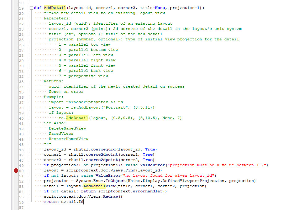

It fails at line 10 in the AddDetail function.
layout_id should be valid for all I know as all the checks below have not given any reason to suspect otherwise.
lay = rs.AddLayout("TestLayout",(a4w,a4h))
if not lay:
	print("Error in creating layout")
ret = rs.IsLayout(lay)
if ret == True:
	print("Is a layout")
	sideview = rs.AddDetail(lay,(0,0),(a4w/2,a4h),"Side View",3)
	frontview = rs.AddDetail(lay,(a4w/2,0),(a4w,a4h),"Front view",1)
So IsLayout returns True and then in the AddDetail the :
    layout = scriptcontext.doc.Views.Find(layout_id)
Line causes the crash…
