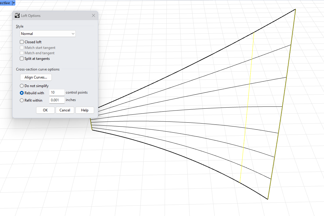

In the attached file I have a set of three curves I want to loft. Yet the loft command wants to go to the far side of one of the curves.
those curves are insanely complex for what they are.
rebuild them and your loft will go much better-
you can also just use the rebuild option in the command itself-
