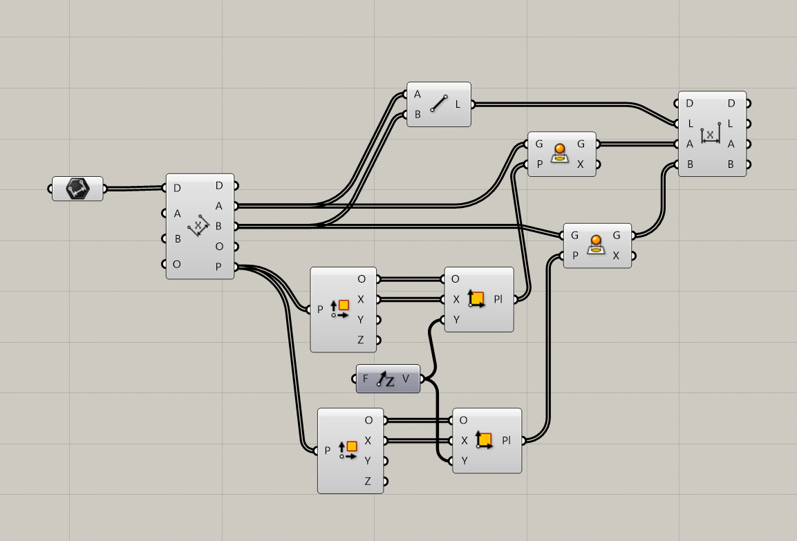

Hi. After deconstructing linear/aligned dimension in grasshopper, it does not construct back the same again. Dimension lines are pointing random directions.
Original dimensions:
New dimensions (that should look exactly the same):
What are the possible workarounds?
The workaround I found. Tried a bunch of different things, that is pretty much the only thing i found to work.
Updated rhino, still not perfect, now the workaround looks like this:
