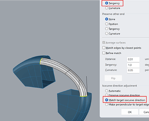

Hi All, @Gijs ,
I’m having trouble today using the BlendSrf command.
As you can see in this picture the connection between this 2 pieces produces a weird result.
I’m expecting somethign more like the Sweep2R (on the right)
I’m not understanding why the interior shapes options isn’t available.
On other part of this model enabling the option solved the problem (increasing the number of handle)
This is the file 20250826_BlendSrf_BUG.3dm (2.7 MB)
My version is Rhino 8 SR23 2025-8-20 (Rhino 8, 8.23.25232.17001)
I downloaed the file, used BlendSrf and the results were the same. Definitely not the expected result. I also call it a “bug”.
BlendSrf blends perpendicular to that edge, so basically, we need
RH-9594 BlendSrf: Force isocurve direction
I’d loft
Followed by MatchSrf:
Then EndBulge optionally to adjust the shape

Yes the loft work good, still the Blend acts unexpectedly also because it can’t let me to add the inner shapes.
As far as I could see, it doesn’t allow you to uncheck it.
You’re right.
And then not use them :rofl:
I think the tool doesn’t allow you to uncheck it, because it would not yield a usable result, but to know for sure I would need to investigate deeper
There is something super wrong with the split surfaces that were used as target edges.
In general, I would avoid using multi-span fillets and blends in such scenarios. It may be better to rebuild them to single-span, non-split surfaces via the “RefitTrim” tool, followed by matching their edges to the adjacent surfaces.
In the above video I tried to use one of the workarounds (extending the edge as a separate surface, then repeat that again) that typically work with bad input edges, but this bug seems too serious even for that approach. You will notice that the extended surfaces overlap with the split edges, which is a clear sign that the latter are prone to weirdly split geometry.
Also, by the end of the video you will see that the matched lofted surface has undesired multi-spans and that the rebuild surface does not need so many control points and spans to match within the file’s tolerance setting (0,01 mm and 1 degree).
However, if the goal is to match to a more strict tolerance, such like 0,001 mm and 0,1 degree, then I suggest to bump the degree of the lofted surface before using the “Match surface” tool. The reason for that is trivial - the “Refine” option of the “Match surface” tool adds spans instead of raising the degree, hence the surface quality suffers a lot.
My proposal to the Rhino developers is to rewrite the code of the “Refine” option and allow raising the degree instead of adding multi-spans.
I think that is covered in RH-66370 Match srf UI and workflow improvements but let me know if is not
