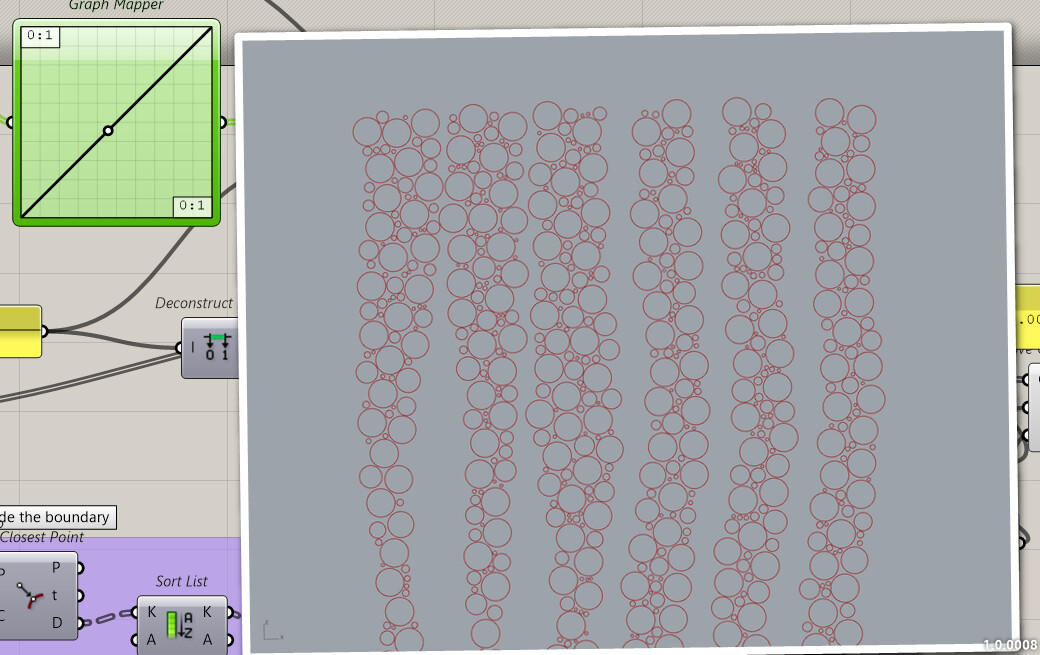

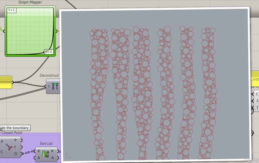

Hello
if you accept my Nautilus plugin, here is a way to generate the circles. if not it could be better to use Kangaroo for circle packing.
First bands are transformed to mesh and populated with lots of points.
Distance of points is calculated relative to the naked edges
A random radius is generated for each point
If radius is more than distance from the naked edge the distance from naked edge is taken.
If radius is too little the circle is removed.

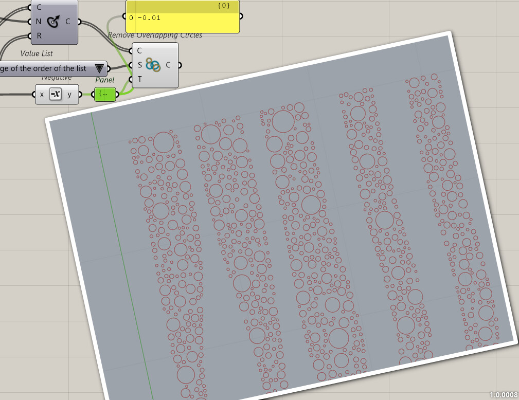

Then I have a little tool to remove overlapping circle. The negative tolerance is used to put a distance between circles.
Many variations could be obtained depending on the option for the circle removal
Perforated Panel - Wiggle-Circle LD.gh (29.6 KB)

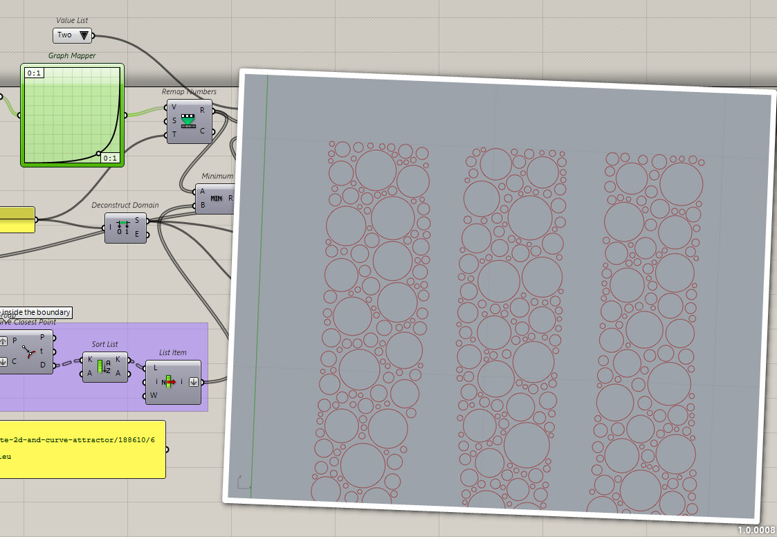

A bit better, with and without border
Effect of the distribution or circle radiuse
Perforated Panel - Wiggle-Circle LD2.gh (35.9 KB)
