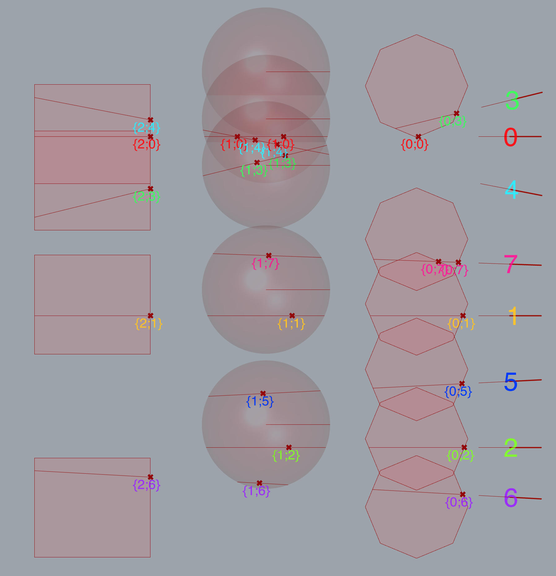

i am struggeling with the Brep Plan section component to recreate an data structure equal to the inputs. I want to use a variable amount of brep containers (A, B, C…) which should be intersecting with planes based on an variable line count (1-6).
as seen i managed to creat a data structure which has a branch for every plane but i additionaly want it to be divided by the input containers to have a total of 18 Branches (A 6 Branches, B 6 Branches, C 6 branches). as already mentioned the amount of planes and container should varie unfortunatly i am not able to script this so i would highly appreciate help from you :slight_smile:

thanks for this approach but its not fully what i try to achive maybe this picture clarifys:
the marked curves shall be in one branch even if they are not refering to the same object but because they are intersecting with the same plane.

f.e. 6 planes which intersect an object once (A) intersect multiple objects (c) or an object intersected by multiple planes (b). the new data tree should be based on the plane but also on the a,b,c containers. so the result should be A;1-6, B;1-6, C;1-6 in this case 18 branches

Is this what you’re trying to get?
Plane_Intersection_kr01.gh (477.7 KB)
-Kevin
amazing thanks a lot! i aimed to replace the first part with one dynamic geo pipeline streaming multiple layers represented by the group and merge component but the path mapper does excatly what i try to achive
