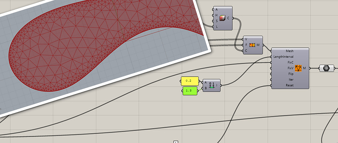

I am attempting to play with kangaroo for the first time and am a little confused. I am trying to create a circle packing similar to what is seen here:https://www.grasshopper3d.com/profiles/blogs/meshmachine-update?id=2985220%3ABlogPost%3A1085830&page=5#comments

I have attached my file any help would be appreciated.
Triangle mesh and circle packing.gh (22.2 KB)

The most up-to-date source of example files for Kangaroo is here:
I’m working on some components to simplify this sort of remeshing further, but in the meantime here’s a definition that uses only components contained in the current Kangaroo release for Rhino 6, to hopefully make things easier in terms of library references:
boundarypack.gh (15.7 KB)
It’s still a multi stage process for now.
I’ve numbered the steps you need to apply in the definition
- remeshing according to distance from boundary
- Data-Dam to pass the mesh to the next step
- Start the relaxation

One follow up question how do you set a maximum radius?
Thanks
In that definition, the values going into the ConstructDomain component set the radii at the boundary and interior.
