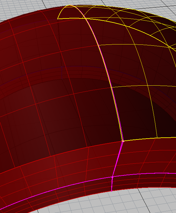

Problem here with this top surface overlappng…and more down the side. Inside ring surface was okay.
Extract the top surface and from the front view Split at the top to remove the overlap.
Edges don`t align here on the sides
Nor here.

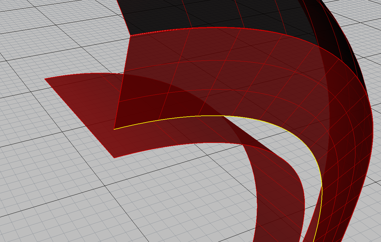

I split your ring into a Quadrant before this next step to save work. Duplicate this edge and then delete the surface above it. I have already deleted the one below.
The end does not align with the plane so turn points on for the edge you just duplicated…
…then in the left view project the end point to the cplane.

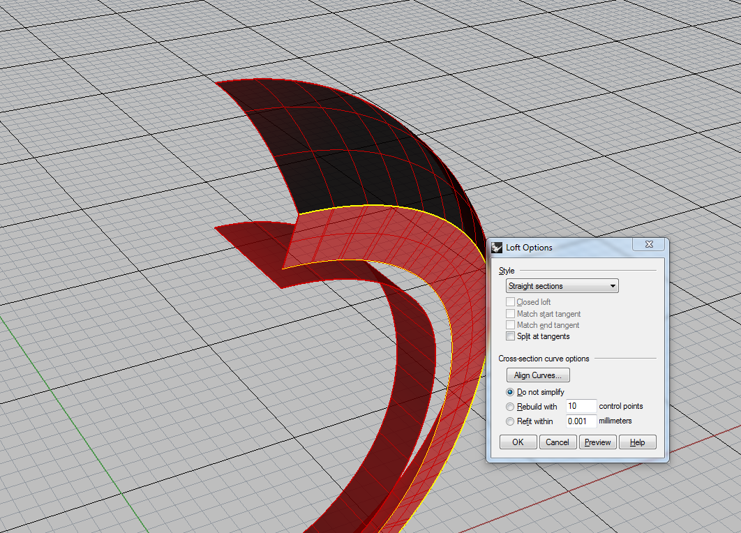

Loft away twice to recreate those two surfaces.
Join them all up.
Apply quad symmetry and join to give you a closed polysurface.
Boolean and done. HTH
