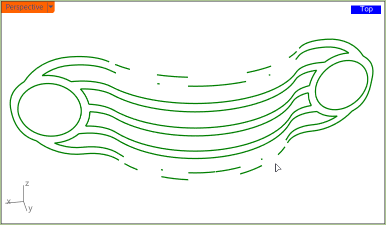

again boolean trouble.
I can’t find anything wrong with the intersection…

I haven’t looked into this very closely but just opening this file in Rhino 6 and hiding the curves, then intersecting the two objects gives me this:
and obviously, this won’t boolean. Did you do something to the tolerances before / after getting your intersection curves?
Oh, that is ugly.
And of course this won’t bool.
In V5 the intersection is complete and closed (see file).
I did not play with the tolerance.
This means, in V6 it is even worse…
A good reason to find out what’s going on.

Hi @Charles, move the pipe part in positive y direction by 0.0005 millimeters and it should work. Btw. why angle tolerance of 3 degree ?

Hi @Charles,
the source of the problem seems to be a bad parameterisation of the piped part. You can get away of that without moving the part by doing this:
_Explode the piped part_JoinNow just do the boolean and it works. Btw. did you use _SrfSeam on some of the pipes ?

Hi All - thanks for digging into this - @clement, good catch on reprameterizing - Automatic does not work, but 0-1 does…I’ll send this to the bigger brains.
https://mcneel.myjetbrains.com/youtrack/issue/RH-38416
This is fixed for the next WIP. There is still a problem with Intersect. Depending on which order you choose the objects, Intersect will either get the full curves or miss some pieces. https://mcneel.myjetbrains.com/youtrack/issue/RH-38419

I get the same result as Wim, in his post above, if I pick red then blue. The other way I get the correct curves.
