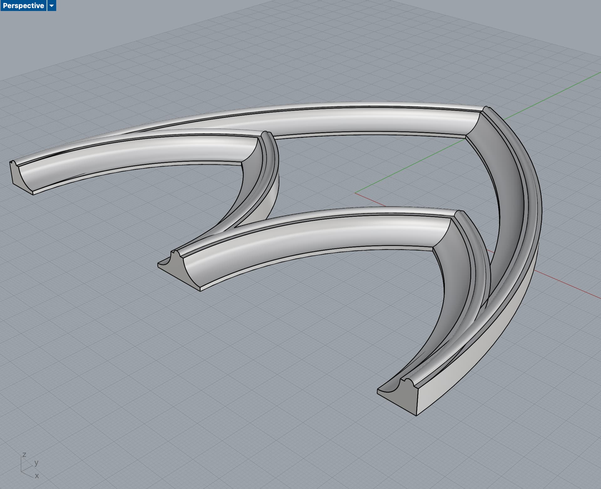

Hello. I have a technical question. I’m on the latest version for mac.
I have here some simple arches. I want to boolean these together, but BooleanUnion fails. I read this article about Booleans in Rhino and i believe it fails due to surfaces being tangent. Rhino cannot calculate the intersection properly and therefore fails.
As you can see here, Rhino tries to calculate an intersection but the resulting curves are not closed loops even though the intersection should be possible theoretically, right?
Does anybody have any clever workarounds for this? I think in this case specifically it would be pretty hard to try and edit the resulting intersection-curves and then split my objects.
As mentioned, I’m on latest version for mac (Rhino 8). I will attach my file. Thanks for your help.

rhino will not find the red intersection.
this is why boolean operations (and trim @theoutside) both fail.
to get the intersection:
_extractSrf (both)
_insertKnot Automatic, 4 or 5 times (EDIT: both directions)
now
_intersect will give a longer / closer result.
_extend the intersection curve
make sure the endpoint is at the midpoint of the arc (move the CV or SetPt)
Screenshot: pipe-like surfaces after inserting Knots.
(before extend)
The surfaces with endless Knots are only to generate the curve.
now trim works with that curve for both (original) surfaces.

… and for lazy people with big bricolage risk:
construct the curve as above
use the curve to split the faces in question (_splitFace Select Curve option)
delete the part of the surface that is not needed in the final solid.
_booleanUnion (the bricolage action)
_explode
_join
Pipes_fixed_bricolage.3dm (1.2 MB)
