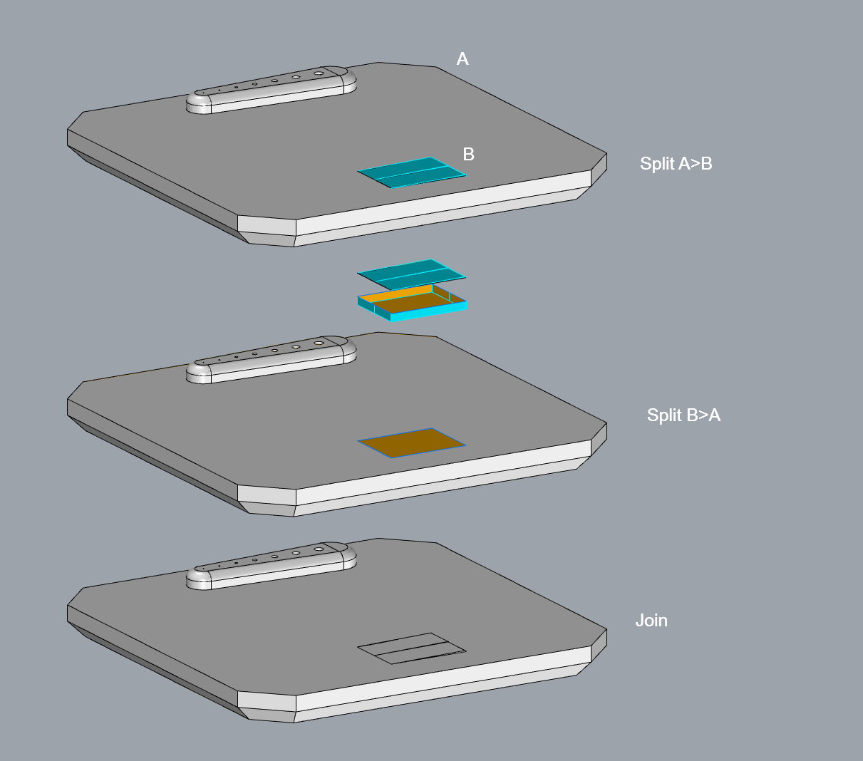

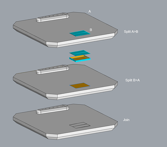

Dear @Steve1
the wedge forms an angle of 0.286 and 0.859 degree.
The result of boolean union changes if you change the document unit angle tolerance.
(but will not result in what you re after).
another way to get an result:
_intersect
_trim (2x)
_join
kind regards - tom
@wim
Note..This was Rhino 8 not 9 failure.
Tom,
will try for that instead.
so angle tolerance is also something to alter, though doesnt work here you say.
I wonder what is the idea of tolerance where all it does is cause us to have to alter it ! :laughing: :weary:
we all want things to just work.
Steve

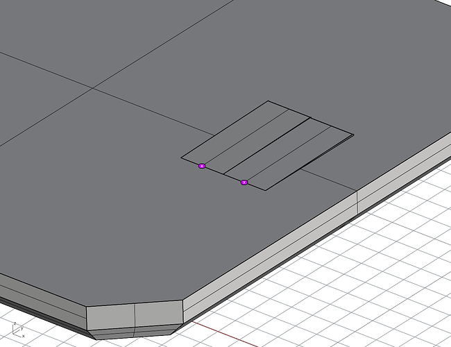

are you sure you got the correct result ?
check those edges marked with (x) (x)
I also tried _mergeallCoplanarFaces and _shrinktrimmeSrf … then boolean union and the result was bad in this area…there are ugly very small angles …
