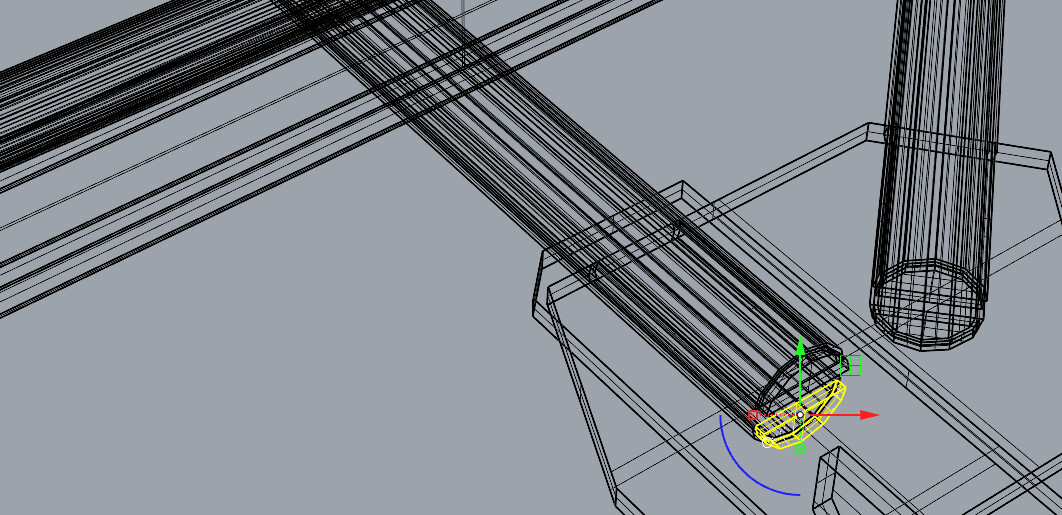

These pipes look like they’re meshes.
You can extract the edges and find the longest ones then create an average which you can use to define a perp frame.
