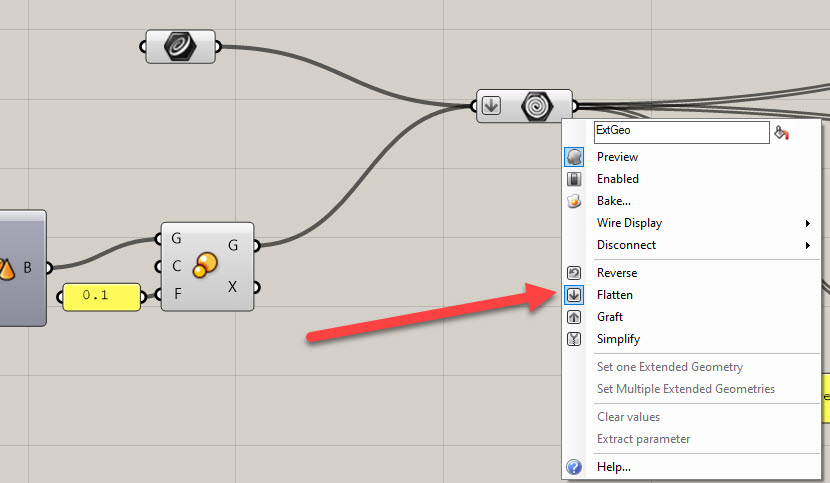

The only thing I feel difficult — I can’t put the block and the curve at the same time within the definition, without the use objects inside Rhino scene (3dm file).
It works if bake and assign it to ExtGeo (set multiple extend geometries)
I tried to connect the node with the curve and with the block to the ExtGeo, but it doesn’t work. Connections become dashed lines
May I ask to help to сombine “a curve and block” into a heap, and make an Imitation “set multiple extend geometries”?

Аnyway I need an Imitation “set multiple extend geometries” to Elefront ExtGeo node.
Thanks
I got it!
I set Flatten. Now it works :slight_smile:
