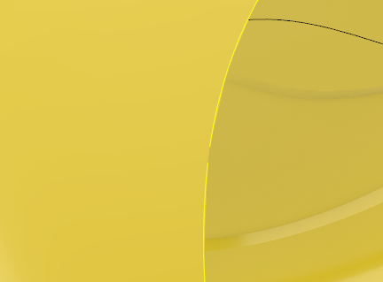

hi, can someone help me with this project? i try to use blend surface for link two surfaces. i find an error, a hole. cap don’t work. the problem probably start in the first use of blend surface. i try to use transform and mirror it but don’t work for the disconnection on surface. i don’t found a good tutorial about adjust surface blend.

Try to use ChainEdge option of BlendSrf to fix your current issue, for you reference.
sorry for the late with answer. i tried and it is works. thank you
