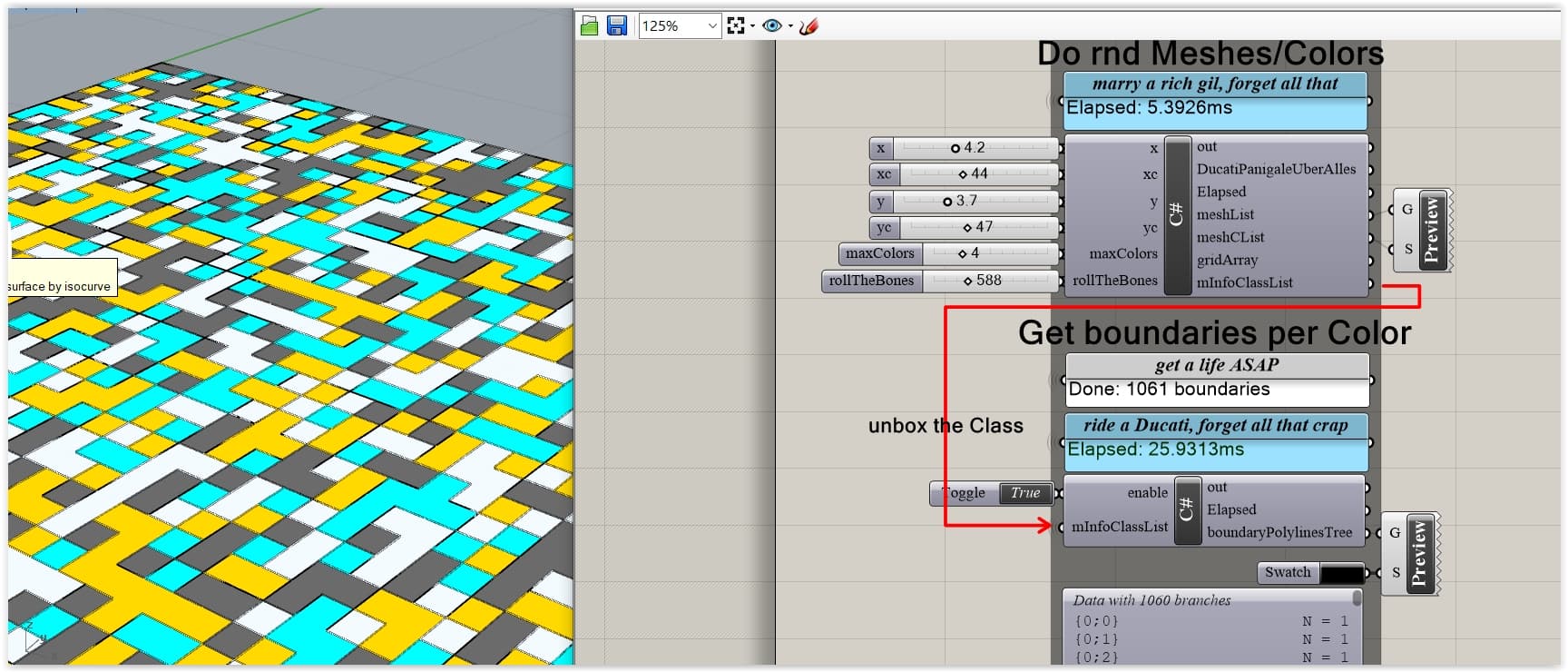

interesting links, good to know what terms to google for. I try to make a fast and scaleable script based upon both your inputs and share the results (optimistically i am aiming for 8k res processing in < 5 sec calculation)

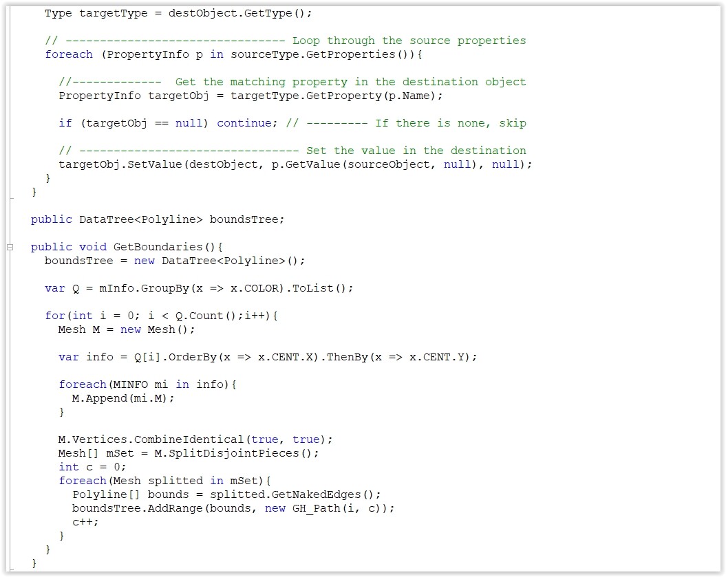

Another - stupid/lazy- way could be: sample your pixels (as meshes) into the Class collection then GroupBy(x=>x.Color), then OrderBy(x=>x.Center.X).ThenBy(x=>x.Center.Y) and Append’m into a Mesh (per Group). Then just use the SplitDisjointPieces Method and then the GetNakedEdges Method per island (i.e. a Polyline where edges are connected with one Face).
But this is indeed kinda flying from DC to NY via LA. In fact is so stupid that I’m tempted to write another C# that is - more or less - the art of pointless.
However … give it a spin (Mesh ops [blame floats] are fast). And your Elapsed target (5000 milliseconds) is rather generous (hideous to me if you ask). All that prior implenenting some // approach (hope dies last).
Update: finish the attached (is pointless but then what isn’t?)
Mesh_BoundariesByColor_V1.gh (11.4 KB)
thanks Peter, :+1:
OK … stupid things are like Cuban cigars: the more the better.

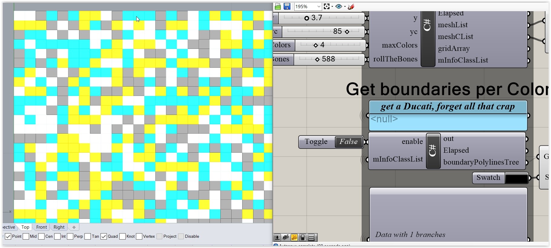

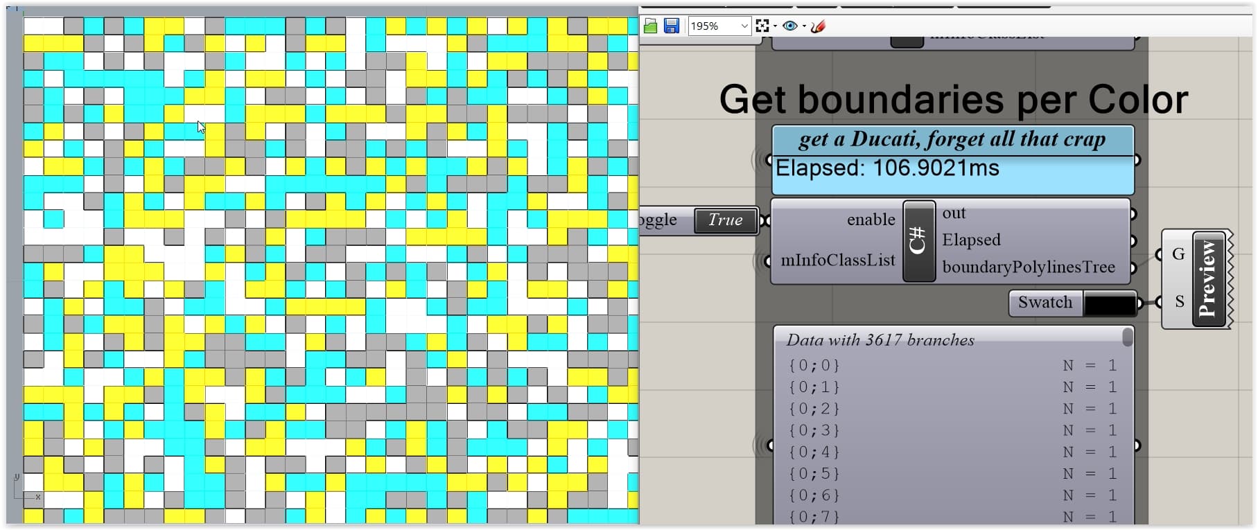

So I did the right (i.e. the wrong) thing. Result? 100 ms VS 7K pixels as Meshes (using an ancient i5 - I always use a crap CPU when writing code). So expect 20 ms max (using ~10+K pixels) on an 14th gen I9 … plus a thread safe // approach.

  1. Define the Class (and rnd test Meshes/Colors) in one C# - the first as captured above.
  2. Unbox (*) the Class content (as List of Type object) in a 2nd C# and then do the boundaries as explained above.
(*) notify if you don’t know how to do that.

Get the part related with reading a Class defined in one C# i.e. unboxing it in another C#. Always do that for more than obvious reasons.
Input the Class content as a List of type object, define a Class with exactly the same Properties (as the OEM) and then do:
So as a challenge try to put’m all together and … if you’ll hit the wall … notify (the full thing is waiting for you).

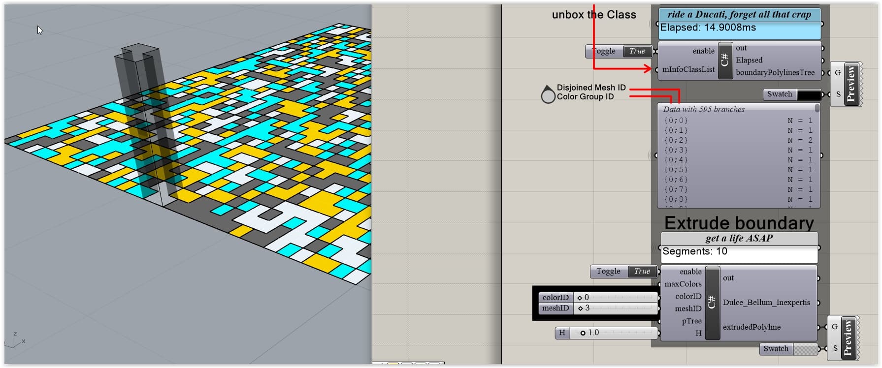

Added a 3rd C# that does the viz part:
