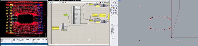

Please see snaps
Tekla doesnot select gridlines when I try to select multiple objects using the Model object component. So I used Tekla pipeline. I dont know how to select multiple items in selection type filter in Tekla Pipeline hence used Panel

Is that the expected result for one grid? The example was for a rectangular grid, radial grids need to be handled in a separate stream. The coordinates for a radial grid will come out of the Expand Object component as well, they’ll just be called AngularCoordinates, RadialCoordinates and CoordinateZ instead. Getting the curves from that is a fun GH extercise :slight_smile:
