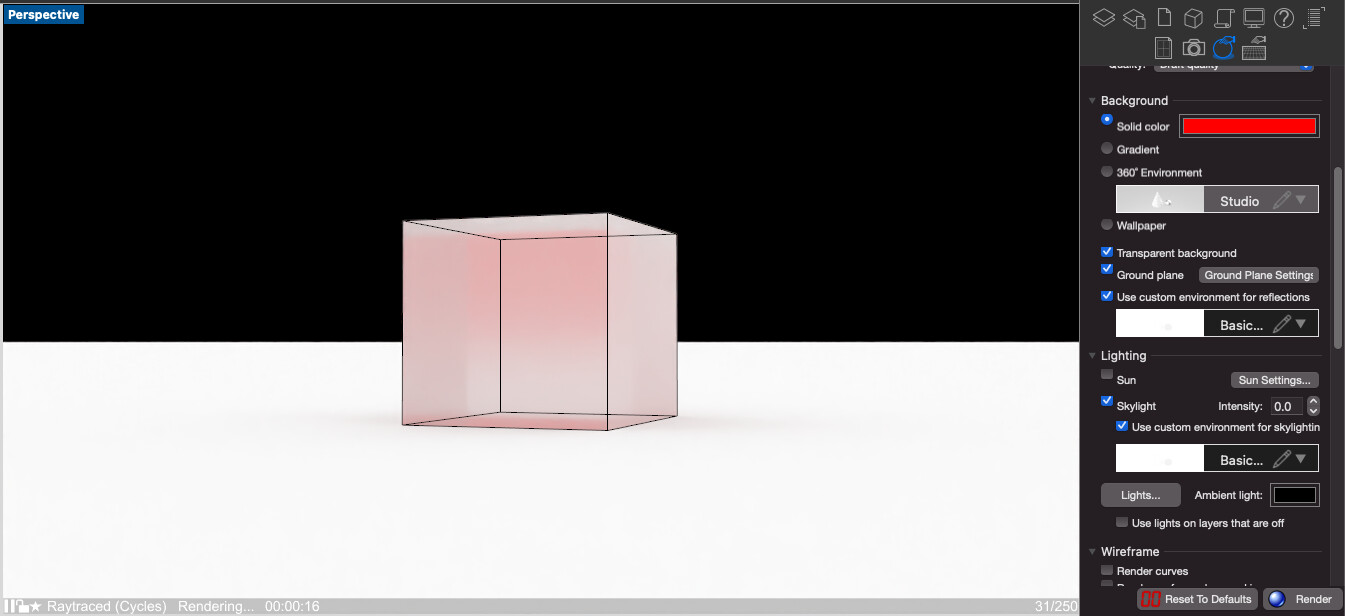

The bug is that with your custom basic environment just the color doesnât work correctly. For that indeed you have to work around with Single Color texture for until fixed:
RH-61842 Basic environment with only background color set doesnât work correctly in Skylight
Yes, we have opted to show what is in the background through transmissive and transparent surfaces.
Say you have set the solid bg color to white. Now you have a reddish color in the skylight environment. A glass orb would show through it red instead of expected white.
Iâm finding the opposite is true. A white environment with a red background results in a red glow.
Edit: maybe the above is confusing because I have transparent background turned on. Here it is with it off:

@nathanletwory if you would look closely to my screen you would see I try to change only the backdrop - breaking down things below:

How it works now:
The background is set to be an environment to illustrate, but if we were to use any other environment to show through the glass bowl youâd get an ultimately weird effect - a small part of a completely different environment from what you expect.
Whatever is in the background section is what is your environment. With nothing set in custom reflection environment this is also used as reflection environment.
If you have skylighting enabled, the setting for what is in background is used for skylighting. Unless you set a different environment.
What I do see though is that the background does appear to contribute somewhat to diffuse bounces. If I recall correctly this is due to how skylight sampling is implemented in Cycles. Iâll log a bug for it ( RH-61843 Background slot environment appears to influence diffuse bounce of rendering )
This is how it works.
But donât forget that there is also transparency⊠A glass over the black background will show the black background through it. A glass over a white background will show white through it. Or whatever you have set in the background section, as I showed.
