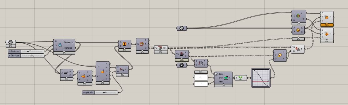

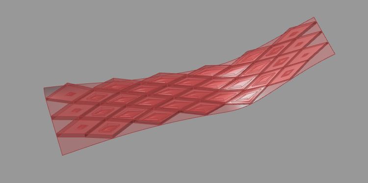

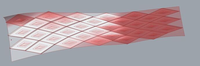

Hello. I am new to this grasshopper stuff, and I have gotten myself in over my head. I am trying to make this diamond pattern on a surface. I got this far, with some help. I want to add an attractor to it to get it to fade. I can’t get it to work.
Any ideas?pufferfish test next4.gh (13.3 KB)

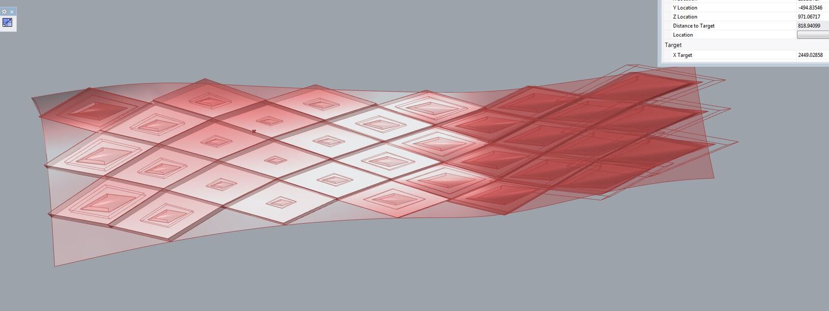

Very cool… just trying to figure out why that works. I need to switch the attractor the other way round.
I hope this might help…
pufferfish test next4_re2.gh (90.1 KB)

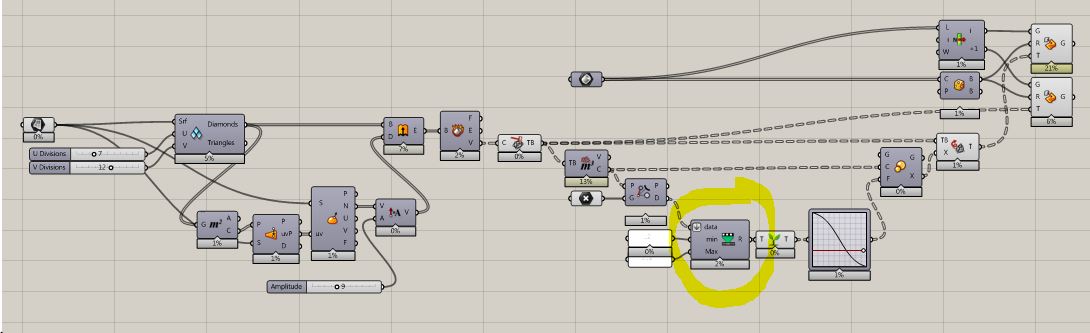

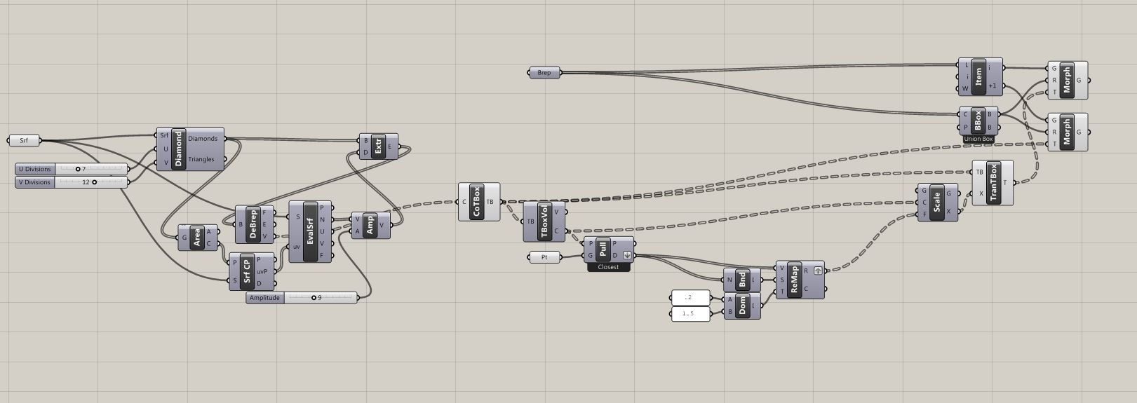

Thank you. I tried it and it doesn’t seem to have an effect.
You should install remap+ to make it work.
What is remap+? in your screenshot is the regular remap component. Or at least looks like it.

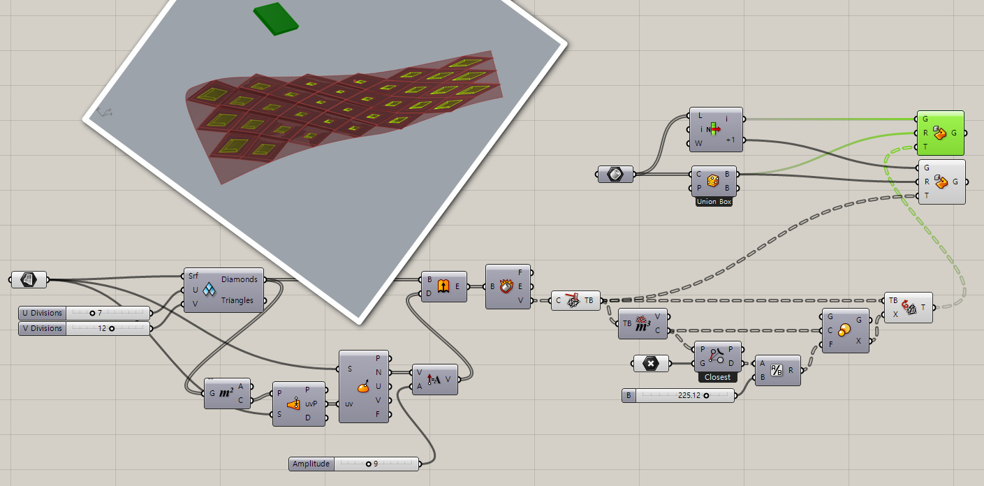

remap plus takes min max and auto sizes to bounds rather than domain. seems silly to me!
Andrew was right… Have a look
pufferfish test next4_re3.gh (93.0 KB)

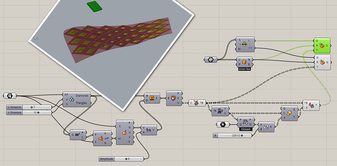

I have not been able to get this to work
