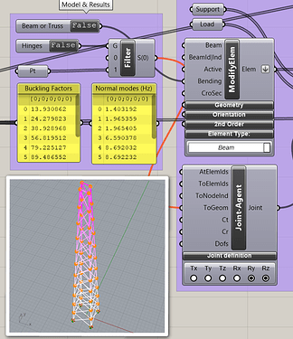

I want to compare the differences in buckling behavior between modeling a lattice tower either as beams (3 rotational + 3 translational DoFs) or as trusses (3 translational DoFs): BeamTrussHinges.gh (84.6 KB).

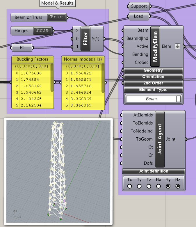

However, I obtain much lower buckling factors using beam elements (4.28) than using truss elements (13.93). Even lower buckling factors are obtained (1.68) in case hinges are introduced at each nodal position of the beams (Joint-Agent component). This is quite counter intuitive, isn´t it?

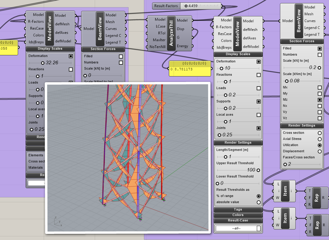

Below My in Beam case :
My in Truss case :
My in Beam with Hinge case :
Maybe the ToGeom input is not the good way, try to use beam-joint-agent on all your diagonals to columns with an RY RZ relaxation, and with a beam-joint set a relaxation un RY, RZ on only a one ends of yours columns (To avoid having too much relaxation on a node).

I agree with you, the relaxation is not being effective. My hinges are nor releasing momentum at all. In fact, the hinged beams structure develops more momentum in diagonal beams in comparison to the not-hinged beams structure. Note that the same scale is used in both images.

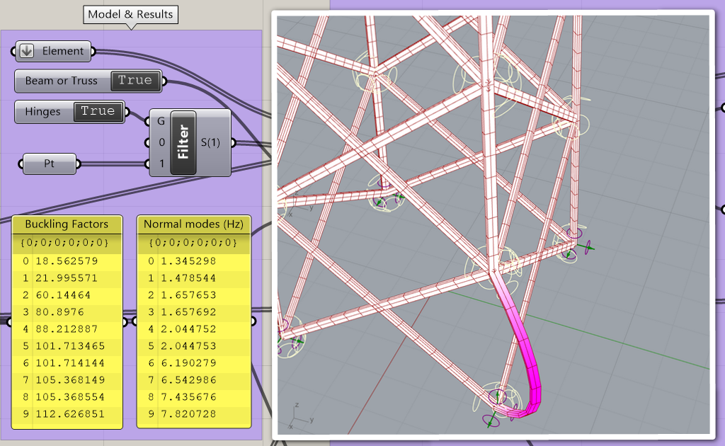

Look your deformation for each buckling mode,
On your first buckling, depend of your version,you have a global or local buckling mode
So you cannot compare your values if it’s not the same deformed first mode…

Similarly, it is also unfeasible that the “hinged” version locally buckles since we have just seen that the hinges are not releasing moment transfer…

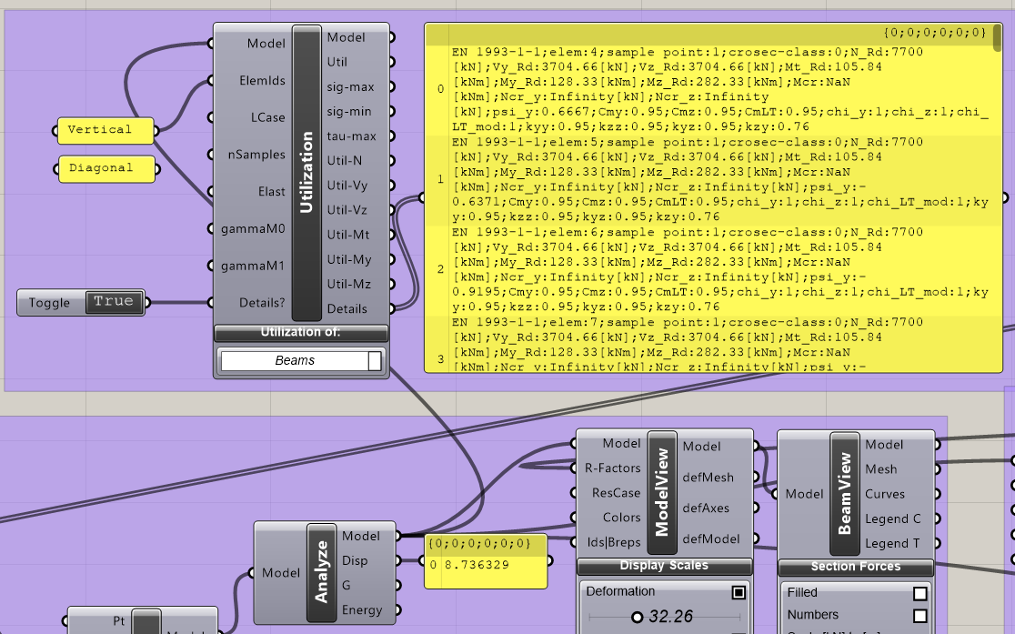

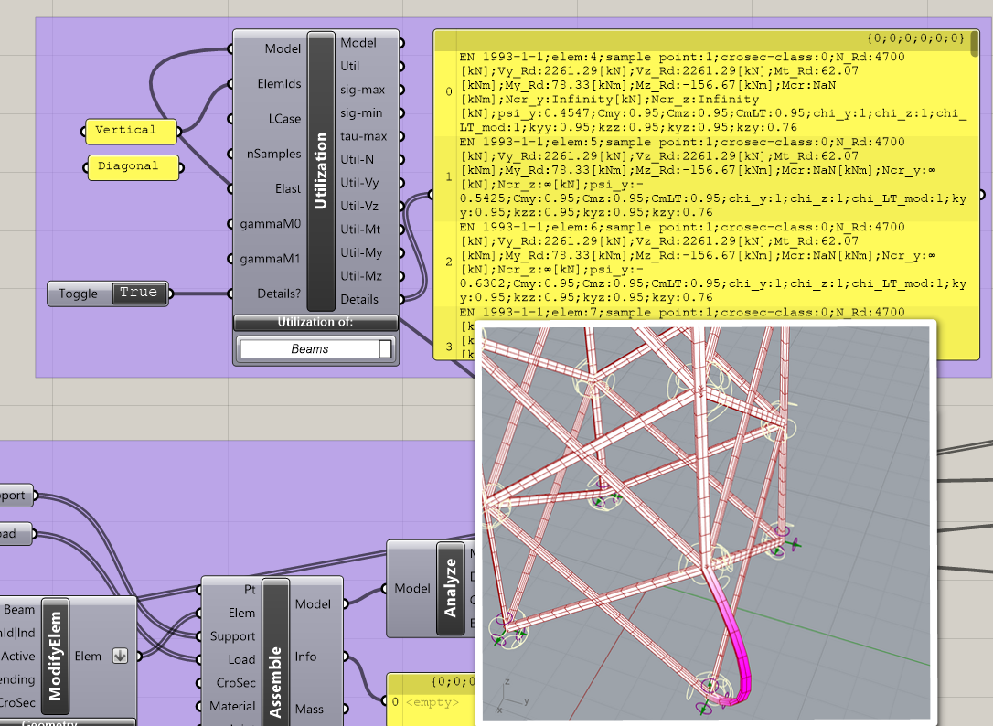

Perhaps this helps to find what´s wrong. I´ve just realized that the Eurocode3 details reported from Utilization component are a bit weird with my model. Ncr_y and Ncr_z should not be “Infinity” nor Mcr “NaN”, am I right? Please, correct me if I´m wrong since it is my first time playing with Utilization.

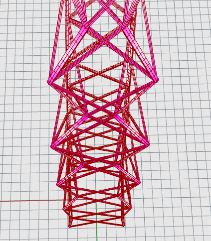

In your truss versions, your first buckling mode seem a global mode.
When we see this kind of deformation, its look like unstable structure (but it’s not i understand :slight_smile: )
Personally i find this deformation very strange, that why i asked you if diagonals are connected each others or not.
But finally this modal deformation shape is very close to the first buckling mode with beams versions
Hi Jacques,
The shape of the buckling mode you´ve pointed out is expected since it should be easier to displace the nodes radially than in the circumferential direction (where the diagonals would be strongly deformed comparatively). But it may be confusing that the diagonals are not joined together in my model :slight_smile:.

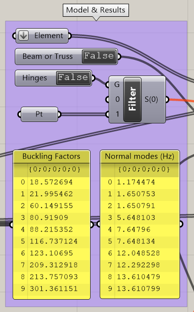

Hello @Vigardo,
the reason for the difference in the buckling load factors is local buckling of the beam elements. If one uses large values for Iyy, Izz and Ipp the results from the beam and truss buckling analysis coincide:

Did you use Karamba3D WIP version for setting up the definition? The problem with the NaN-numbers in the EC3 details was due to a missing material reference. This should not happen from one ‘official’ version to the next.

Hi Clemens,
Now, I think I understand. Please, would you tell me whether I´m right or wrong in the following points?
  1. My truss alternative is more rigid because Karamba truss elements can´t buckle, i.e. they are infinitely rigid.
  2. Karamba´s beam elements (even just one) appropriately consider local buckling (Euler buckling of a single beam). (I´m sorry, I though that I had to use several of them to achieve this behavior :slight_smile:
  3. The most detailed way to model a real truss (where elements can buckle) in Karamba is using beam elements with hinged ends.

However, the NaN numbers in the EC3 details issue still remanins, even upon updating Rhino to 2.25 and Karamba to your latest 1.3.3 version. Please, you can check it in the image or in BeamTrussHinges4.gh (146.3 KB) (this file is just your previous BeamTrussHinges3_cp.gh but with a newly created material and cross-section) Am I doing something wrong?

Hi @Vigardo,
ad 1.) The geometric stiffness for truss elements takes into account of the lateral forces due to NII at their end-points only. However they can not become unstable via the second Euler buckling case. Truss elements only take axial loads. A bending stiffness does not exist, therefore no corresponding buckling mode.
ad2.) yes
ad3.) yes
I think the problem of the definition ‘BeamTrussHinges4.gh’ is the use of internalized elements which are rooted in a WIP version. Could that be?
The normal modes are different because truss elements can not buckle in an Euler mode due to lack of bending stiffness and corresponding degrees of freedom.

I finally found what was wrong with the “Infinite” Ncr_y issue. For some reason, I had two Modify Cross-section components sequentially connected. The first one adequately set the buckling lengths, but the second one was unintentionally removing the buckling length because it had no input connected (the latter override the former and cleared the required input fields).
I think I added such stuff while debugging the NaN issue in EC3 that probably was caused by the utilization of a WIP version of your excellent software.
