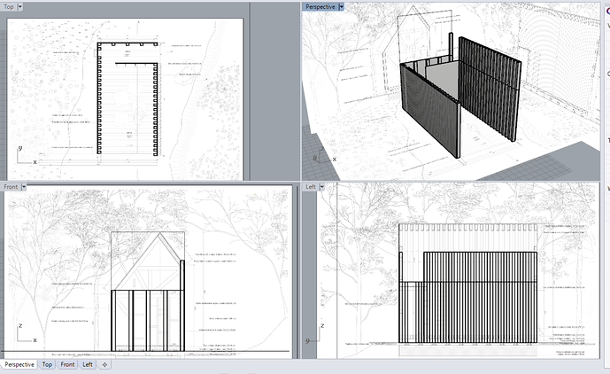

im working on a case study of the “Chapel of Silence by the Studio Associates” and this is my first time using rhino so i am struggling a lot with actually managing to make this structure by the deadline 1/30. for now my main issue is trying to find a way of designing the roof of the building at the angle its portrayed. moreover, the multiple wooden supports are difficult to create and match up perfectly, is there any suggestions for making them nicely spaced, lined, and thicknesses?

You can draw elements as Polylines and then use ExtrudeCrv, eventually ArrayLinear to spread elements around.
You can find many modelling video tutorials on this amazing channel: https://vimeo.com/rhino
