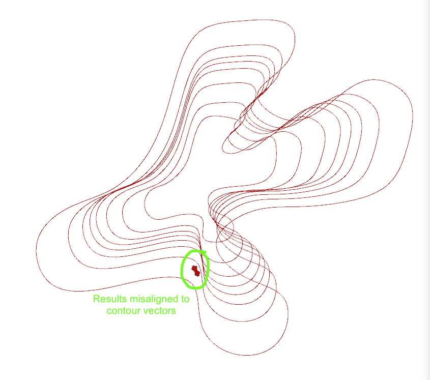

I’m working with two sets of vectors in Grasshopper: one grid of vectors representing a force (e.g., river flow) and one set of contour vectors from a shape. I need to filter the contour vectors so that only those pointing in the same direction as the grid vectors are kept, with a tolerance of -0.2 to 0.2 . The problem is when I use vector display on the cull pattern I have created, the results are misaligned with the contour vectors.
How can I filter the contour vectors based on their direction relative to the grid vectors, with the results aligning to contour vectors?

Vectors on their own mean nothing because they don’t have a starting Point, so if you want to measure the angle between two “close” vectors in that grid in order to filter those which fall into a given angle-range, you might want to compare the points on which they are applied, and from those get which vector it’s being pulled?
I would do something like the following:
River_Flow_Force_Re.gh (36.9 KB)
note that the Angle component computes angles between two vectors, and that angle is always positive, so the filter <= 0.2 should be enough to encompass the [-0.2 to 0.2] Domain
Great, exactly what I was trying to get. Thanks a lot!
