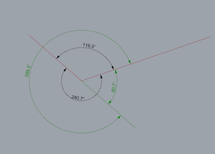

Hey guys sorry I’m a grasshopper noob but I can’t figure out why the angles are wrong between grasshopper and rhino…

Hey I figured it out that GH is calculating the first line like it is the ground plane scaling off into infinity.
Green is how GH sees the angle…
Kind of confusing i need to a subtraction node to get the right numbers…
