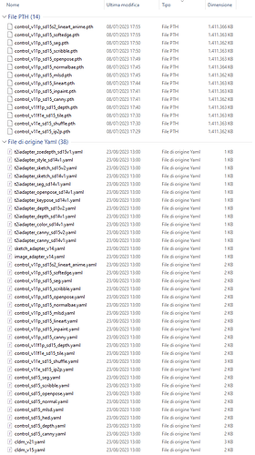

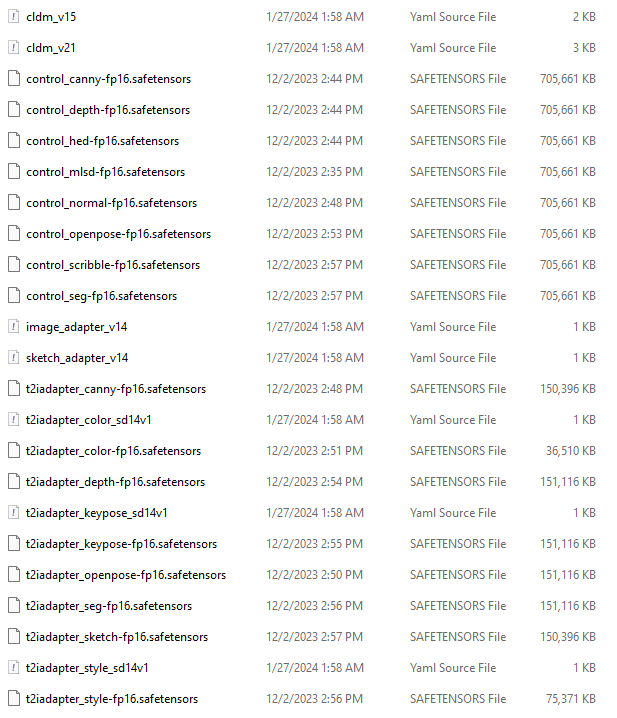

What controlNet version did you install? it seems the CN v1.0, anyway please, see below:
1) Have you installed the ControlNet checkpoint models? please, have a look below, this is my folder content for ControlNet v1.1.313 (path: SDlocalCNv11\stable-diffusion-webui\extensions\sd-webui-controlnet\models)
Here is where to download the models: lllyasviel/ControlNet-v1-1 at main
Evaluate the possibility of using this version.
2) this one is for CN v1.0 (path: SDlocalCNv10\stable-diffusion-webui\extensions\webui-controlnet-v1-archived\models)
Here is where to download the old models (only for CN v.1.0): lllyasviel/ControlNet at main
Check here for extra info: GitHub - lllyasviel/webui-controlnet-v1-archived: WebUI extension for ControlNet (v1 archived)

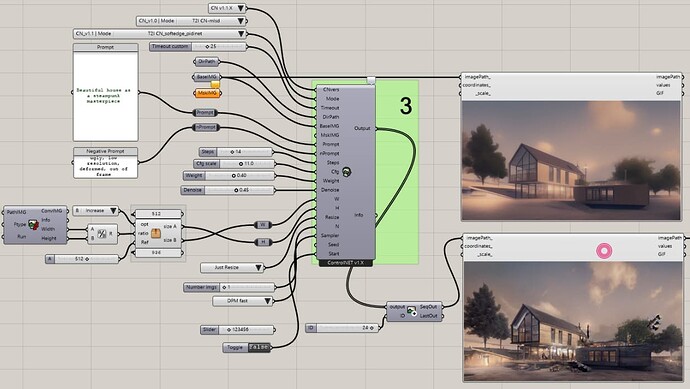

@Ambrosinus has there been any further development in getting the SD components to be compatible with Controlnet v1.1.x? Iā€™ve got everything working within Grasshopper but unfortunately the components arenā€™t responsive to any image inputs I provide. Just curious if youā€™ve been able to get v1.1ā€™s API to work with this plugin. Thanks very much for the work youā€™re doing with this tool, very impressive!
Hello and thank you for the feedback.
it seems that Automatic1111 has updated some API features. I must investigate this for the component written in C# ("DalleFromGH), but the component developed in Python (the advanced one) still works. Remember that the advanced version needs an earlier installation of some Python libraries.
Please let me know how you feel about using this version instead of the more limited light version.
Actually, Is it possible to use the CN v1.X so thatā€™s what thereā€™s the ā€œModeā€ parameter. I noticed only a couple of checkpoint models such as ā€œmlsdā€ that seem to not work properly.
Generally, if you encounter some difficulties in generating the images (for instance you obtain images different from the source) it can happen due to the installation process.
Basically, I suggest having two different folders for the Automatic1111 project, one with the CN1.0 version and the other with the CN v1.X.

Grazie mille por queste informazione @Ambrosinus ! I was able to get the secondary SD install with CNv1.0 working per your recommendations. Iā€™m realizing now that the AIImg2Img component isnā€™t available yet, and that the demo on your website was a preview, so I guess Iā€™m a bit ahead of myself in what Iā€™d like to do. In selecting canny, for instance, Iā€™m getting the canny preprocessor image as the output, rather than a modified version of my base image using the canny preprocessor. I will excitedly await the next version of your plugin!
Hello and happy to see this! :blush:
With version 1.2.6 you should find the AI variation component (ImgToImg) in the top toolbar. You are right I did not realize the traditional video about how to work the component, but it is already available in the AI subcategory. Here is the article
Remember that at this link on my GitHub, you can find also the gh demo file :wink: (this one : SD_Local_ControlNET_v10-11_v126_AIvariation_base&server_demo-01.gh)

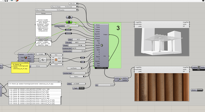

Hello, dear Ambrosini,
Thanks a lot for your very helpful tool!
I have a problem with the result.
I have installed a new version of Automatic1111 with ControlNet 1.0
The results are way different than the screenshot taken from Rhino. And I guess it could be due to the index of the controlnet models.
How do we know the index of the models. Is there a component like the SD models info component which shows the models and the indices?
Also, a note, when working on the same installation of Automatic1111 with the same screenshot, the results are fine.
Hello, thank you for your message :blush: Right! When you use CN v1.0 from the setup launcher you have to set up the Automatic1111 folder wherein you downloaded the CN v1.0 and vice-versa when you want to use the SD with CN v1.X. This is the only way to sync Rhino+Gh with the right Stable Diffusion API.
About the right index for now the best way is in using the value list presets. They have been marked as CNv1.0_Mode and CNv1.X_Mode. Remember also to switch the param ā€œCNversā€ according to the SD version launched at the beginning. When the ā€œblack viewport from CMD commandā€ starts, you can read the name of the Mode selected. Anyway, the ordered list of all models included is coincident with the list inside the Grasshopper value list provided with the gh demo file.
