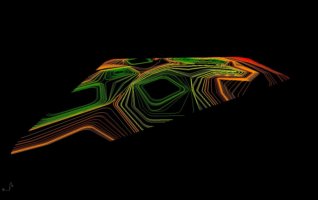

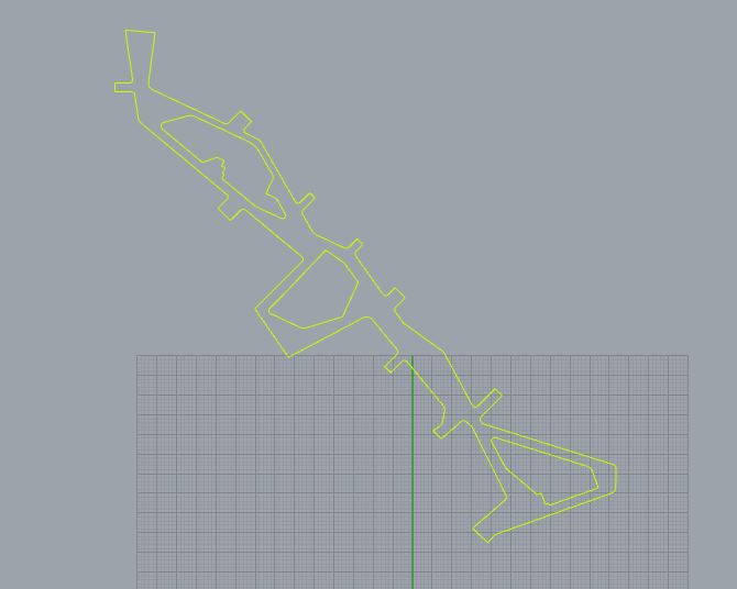

The first, is that I want to have the tween curves between a closed outer boundary and multiple inner closed curves. I have tried tween curves but they don’t seem to work properly.
The second Idea I had was to create a “topography-like” surface, and then extract contours. But I dont seem to manage to have a seamless loft between one single outer curve, and multiple interior closed curves.
I am attaching the 3dm file for you to see, and one image as a reference of what I would like to achieve.

I have tried Metaball but it only accepts points as an input. Is there a way to insert predefined curves?
