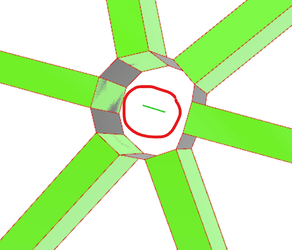

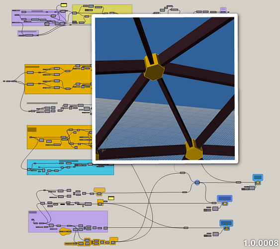

Hello everyone, I’m working on a Geodesic Dome project and am trying to create a structure as similar as possible to the attached image, where the connectors (vertices) and beams of the structure are aligned. I’ve tried several list and geometry approaches, but to no avail. Can anyone help me?
LuSilva_GeodesicDome_REV13.2.gh (193.2 KB)
You have the centerline of the connectors in your model already. When you lofted the inside and outside shapes you created the exact centerline you need. Those lines can also be created by joining a point from the center of the sphere to each node of the of the surface.
I attached a revised version of your model. My approach was to create each truss member. Once I had those I found the boundary curves at each node point. The boundary curves were connected and those are your connectors. The points of each connector boundary are not planar, so the cap holes does not work. You will need to figure that out.

So, I combined Brad Shipton’s solution with an approach I was already working on. I think it worked very well. Here’s the result. I plan to gradually improve some aspects in the future, but for now, I’m pleased with the results.
