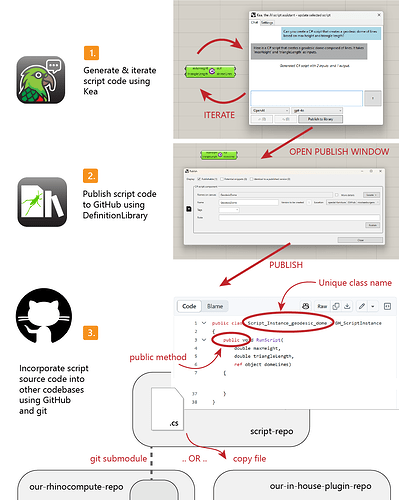

For those reading this who are also software developers:
This is an example flow where you use Kea to iterate the code, and then, when you’re happy with it, publish it using DefinitionLibrary which alters the code just enough to enable you to integrate it into other codebases:
This provides you with a convenient way to use Grasshopper as a prototype/testing environment for any code that uses RhinoCommon to generate geometric output and progress it towards being part of your own custom plug-in, or Rhino Compute fork, or a shared code library for other similar purposes.
